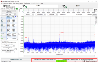

I have a TSW14J46EVM and and ADS54J40EVM aand I am trying to use the HSDCPro Automation DLL to automate the data capture using MATLAB. I have a few questions on getting it to work
1. My board serial number is T827D8un as written on the board - so when I pass the board serial number, have it asT827D8un-TSW14J56revD ?
2. Also when passing the ADC device name, is it supposed to be passed as ADS54J40 or the actual ADS54J40_LMF_8244 ?
3. I am running MATLAB R2020a and when I try the commands with int32_t I am given a prompt to use int32 instead. Is this to be expected?
4. Whenever I run the commands like connect_board, disconnect_board, etc I get an int32 vector of different lengths as the result, What is this vector of numbers supposed to represent and how to make sense of it?
5. When I run the command connect board with the HSDC Pro GUI open, am I supposed to see the changes in thge GUI corresponding to the command given? I do not see the changes currently

  • Hi Aravind,
    Can you please make sure you get have following package installed on the PC.
    https://www.mathworks.com/matlabcentral/fileexchange/52848-matlab-support-for-mingw-w64-c-c-compiler
    Also can you add the following commands at top of the script before you load HSDCpro DLL.
    addpath('C:\Program Files (x86)\Texas Instruments\High Speed Data Converter Pro\HSDCPro Automation DLL\Manual and Examples\Automation DLL Matlab Example\64Bit Matlab'); %for the MATLAB to use the Additional dependency files like Thunk files, header files etc..
    if ~libisloaded('HSDCProAutomation_64Bit')
        [notfound,warnings]=loadlibrary('C:\Program Files (x86)\Texas Instruments\High Speed Data Converter Pro\HSDCPro Automation DLL\64Bit DLL\HSDCProAutomation_64Bit.dll', @HSDCProAutomationHeader);
    end
