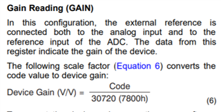

When reading the Code associated with Gain (V/V) (bottom of p. 24), I would expect that the code gain would change respectively.
However, I always read the same value.
1. Please explain why CODE does not change.
2. Please suggest why we experience non-constant readings offsets

    As the datasheet says, the in order to measure the GAIN value, the ADC connects the external VREF voltage to the input and reference. Since the ADC output code is the input voltage (VIN) divided by the reference voltage (VREF), you are effectively always reading the value of VREF / VREF = 1 when checking the GAIN value. However, the actual value you read is not exactly 1x, and this should represent the ADC gain error. You would then scale all of your ADC output by this value, after first subtracting the measured offset.
    As the datasheet text also says, this does not compensate the VREF error, so this would need to be calibrated separately (or in lieu of just calibrating the ADC gain error you would calibrate the whole system error). If you have external amplifiers they can also contribute gain error.
