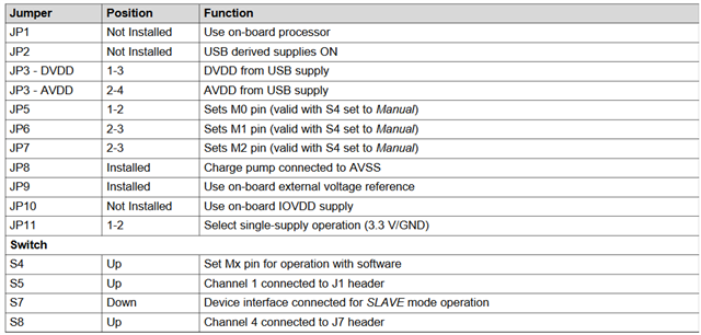

"Yesterday I ordered ADS131A04 evaluation board and i have problems with GUI software.
Evaluation board is setting up in default (according to datasheet) mode:
I downloaded and install recommended software ADS13104EVM-GUI (antivirus disable). Device manager reports not driver issue.
After connecting EVboard into USB LED diode D1,D2 and D4 lights up. Then I tried to start up GUI software and there pop-up window with error report.
I tried all recommended solutions but nothing works for me. So my question is if there is any other solution for my problem?
