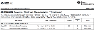

2) according the latest Datasheet of the commercial-Type "SNAS298G –AUGUST 2005–REVISED JANUARY 2015"
    section "6.5 Electrical Characteristics"
    the "fSCLK MIN Minimum clock frequency" is 8 MHz (TYP = 0,8 MHZ, MAX = 16MHz)

    This looks like a typo to me.  The ADC128S102 came from the National Semiconductor team and they had a slightly different way of producing datasheets.  Here is a snippet from the SNAS298F datasheet:
    The National style datasheet used 'Limits' to express the operation conditions under which the electrical characteristics were determined.  Their 'Typical' in the case above was the minimum fSCLK MIN value noted in the leftmost column.  We'll work on getting this cleared up in the next datasheet revision.

    1) What is the "fSCLK MIN" value for the  "-SP"-Type: is it the value which is stated in the datasheet 0,8 MHz (MAX = 16MHz)?
    2) What is the "fSCLK MIN" value for the commercial-Type: is it also 0,8 MHz (MAX = 16MHz)?

  • They are both 0.8MHz minimum, 16MHz maximum.
