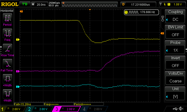

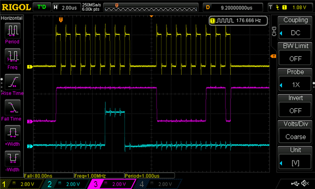

I send a 0x06 command and the 'echo' returns a 0x07 on MISO.
The scope traces tell the story ..
The first trace is the 'overview' .. sending a 0x06 and receiving (supposedly) a 0x06 back.
The second trace is a closeup of the last bit .. showing only 40ns for the ESP to catch the zero. It gets a one instead which is why I get a 0x07 back.
The ADS1261 only allows 40ns on the final bit instead of the 'normal' half clock.
This appears to be too fast for the ESP32.
Am I doing something wrong?
The clock is 1Mhz; MSB First; Mode1
The trace order on the scope images is,
Clock (yellow), MISO (purple), MOSI (blue).
Thanks, Tom

    There appears to be some pretty significant noise on the SCLK line that is coupling into the DOUT and DIN (most notably on DIN). This could certainly be causing issues with the digital communication.
    I would try to isolate the source of this noise and clean it up. Also make sure you have a solid ground connection between the two boards, otherwise communication errors will occur.
    -Bryan

    How long am I guaranteed to have the valid low bit present on MISO after the falling edge of the clock?
    The scope shows its only there for 40ns.
    Looks like part of the problem is the double duty of DOUT ..
    From the datasheet ..
    Propagation delay time, last SCLK falling edge to valid
    data ready function on DOUT/DRDY ----> 110ns
    This means the max time I have to sample the last real MISO bit is 110ns .. but what is the min time? .. How fast does my SPI driver have to be?

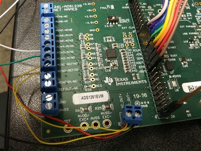

  • Hi Tom,
    Are you measuring a bridge with the AC excitation? If so, what are the bridge characteristics (or maybe a better question is what is the expected output voltage from the bridge)?
    Have you tried probing the voltage on the analog inputs to see if it is switching polarity?
    Can you send the data you are receiving from the ADC? If you have a Saleae capture you can just post that so I can look at all of the data for the SPI signals.
    Can you send me an photo of your system including how the bridge is connected and how the host board is connected to the EVM?
    -Bryan

    Things are improving.
    I'm using an ESP32 connected to an EVM board with J1 jumpered.
    Recall,
    1) Chop mode works great.
    2) I was getting a most significant nibble of either 'B' or '5' (about 50/50), when using AC excitation.
    I implemented CRC to make sure the data coming back was good, which it was.
    After reading the TI "Application Brief' Reduce Bridge Measurement Offset and Drift Using the AC Excitation Mode in the ADS1235 and ADS1261", and reading the fine print on the EVM schematic, I changed from 2 wire to 4 wire (even though there are only two wires to the driver ....)
    It now works fine, almost, at least no  more alternating 'B' and '5'.
    The sample rate, as expected is reduced, however the count coming back is half of what I get in chop mode.
      In Chop  mode the basil value is 0x00, 0x42, 0xF7 (17143)
      In AC Ex mode the basil value is 0x00, 0x86, 0x50 (34386)
      Almost exactly 2:1 (2.06:1)
    This does not make sense according to the docs.
    So, what am I doing wrong this time ?
    I'm including my wiring diagram and the register settings for AC Excitation mode.
    Thanks in advance
    Thanks in advance,
    Tom

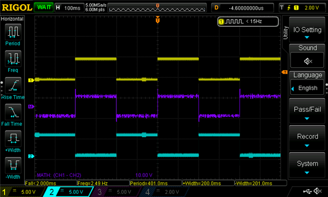

  • Bryan,
    Sorry, I forgot to include the Excitation waveform (Exc+ and Exc-).
    The middle trace is Math A minus B (what the load cell sees).
    It looks Ok to me but you may differ :-)
    Tom

    1) Are the connections correct (see previous drawing) ?
    2) Are the register settings (see previous post) correct for AC excitation?
    3) Do the excitation waveforms (see previous scope trace) look good?

  • Hi Tom,
    The register settings look correct (at least the descriptions, I didn't check the actually bytes you are sending). This would be good to confirm using a RREG command.
    It would help to see an actual picture of the board so I can see where the connections are being made on the EVM. There are some subtleties to this EVM that your drawing does not communicate.
    I do not see anything wrong with the shape of the plots you sent, they appear to be at the right frequency given your selected data rate and filter type (20 SPS and sinc4). It is hard to see in the plots but there appears to be some noise in the output because the waveforms look pretty "thick". You might zoom in a bit more to see what is going on. The noise should ideally cancel out assuming a ratiometric measurement is used, but if the filtering is different between the input and reference this might not be the case.
    The reason I asked about how the noise-free counts were determined is because a scaling factor of 2x usually implies a calculation error. If the difference was random then it might be an analog issue somewhere, or noise may be getting introduced into the system.
    -Bryan
  • Hi Tom,
    It would also be helpful to know what voltage you are actually applying to the ADC inputs. An ADC code value of 34386 when VREF = 5V and PGA = 128 corresponds to a voltage of 160uV. Is this what you intended to measure?
    -Bryan
  • Bryan,
    Thanks!
    I really appreciate the detailed response and am reinvigorated about the project!
    I'm including an image as you requested.
