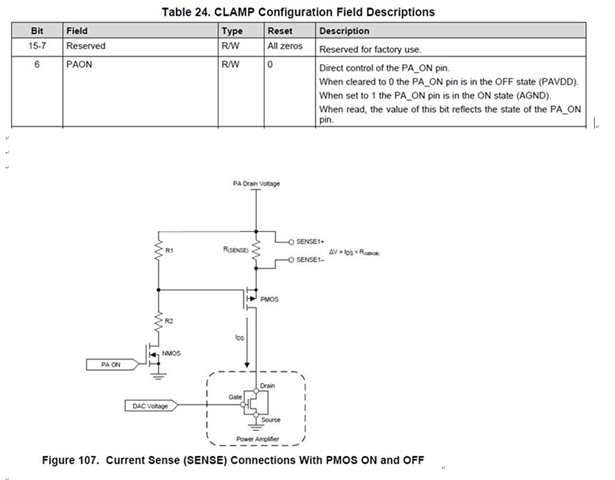

Hi team,
My customer would like to consult with you.
Address 0x17 is the  PA_on status, EVB behavior is the same  as stated in datasheet, set=0, return value=5V(PA off state); Set=1, return value=GND(PA on state).
In the circuit in datasheet p81 Figure 107 does not work as this setting (set PA on bit=0, return value=5V, PA will, expected PA off). How do you suggest for it? Thank you
