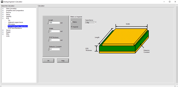

  • Hi Jorge,
    One of the main considerations for the capacitive load on the clock is the board/trace capacitance. With so many devices it can be assumed that there would be a lot of trace capacitance seen by a single clock. You can google how to estimate trace capacitance or you can download our Analog Engineers Calculator and use the included tool (see the screenshot below): https://www.ti.com/tool/ANALOG-ENGINEER-CALC. This would be additive with the pin capacitance, and therefore 15pF may be insufficient even for 4x ADCs.

  • Hi Bryan,
    Thanks a lot for both your suggestions and comments.
    I downloaded TI's Analog Engineers Calculator (which is a really nice tool) and calculated the trace capacitance. Considering a 150mm length (which I think it will be possible considering just 4 ADCs), and the other parameters as you can see in the image below, the trace capacitance will be 7.84pF, with a total of 16.192pF. We know this can vary for many reasons, but I don't consider this as a problem.
