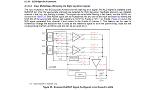

I designed an ECG measurement circuit using the ADS1292R.
I referred to the recommended circuit described in the datasheet, but found that current is sinking into pin 5 (IN2N) and pin 6 (IN2P).
This current flow is adversely affecting another circuit.
Is there any way to set pin 5 and pin 6 to high impedance?

    The device's IN2N and IN2P channel input should always be high impedance (min ≥ 1 GΩ or 500MΩ with leadoff current source). Please verify the channel input MUX setup is in the correct conditions for your hardware design? If all the setup is proper, then the channel input may be damaged due to EOS. Please check to see if you see this on other hardware or only for this particular hardware?

  • Thanks for the reply.
    If I set it as follows, IN2P and IN2N  should be high impedance?
    MUX2[3:0]:0000(default)
    The ECG is generally acquired without any problems, so it is not considered to be damaged.
    The same problem is also seen on other hardware.
    By the way, Figure 35 says the IN2P and IN2N can be set by MUX "1", is this correct?
    Katsuya
  •  Hi Katsuya-san,
    The IN2P and IN2N inputs should be high-impedance when the MUX2[3:0] is set to 0b0000 (Normal electrode input). Sorry, there is a typo in the datasheet for MUXn[3:0] label for channel 2; it should be MUX2[3:0] instead of MUX1[3:0]. Each channel input selection has its MUXn[3:0] setting in the CHnSET register.
