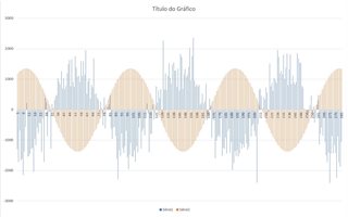

  • Hello Ryan,
    I increased the SCLK to 4MHz and I'm now able to always read data from both devices with RDATA command. The weird thing is that the data from the first device (blue) is not clear as the second device (orange).
    The DRDY keeps happening at every 75us. Do you think that can be related to the bad signal quality when reading the first device?
    Edit: Both signals come from a signal generator (separate channels, same amplitude and frequency) and are only phased in 180° from one another. When reading individually, both signals are ok.
    Thanks in advance.
    Weslley
  • Hi Weslley,
    The DRDYn signal from each device is not related to the quality of the signal at the ADC inputs. It is strictly dependent on the master CLK (internal or external), the internal oversampling ratio (OSR) and the START pulse or START command. In order to synchronize devices with the START command, you must first issue STOP (0Ah). Otherwise, the START command has no effect.
    If DRDYn from either device is not matching the expected data rate, and you've confirmed that both devices are receiving the same CLK signal, then the only explanation is that the data rate is not programmed correctly. Can you write to both devices, then disconnect CSn from one device and read back the register contents? Do this for each device to confirm they are the same. Remember - in order to write registers, you must issue the SDATAC command first. Are you doing this already?
    It may also help if you can share a partial schematic of the two ADCs and a scope capture showing the CLK and DRDYn waveforms.
    Ryan
