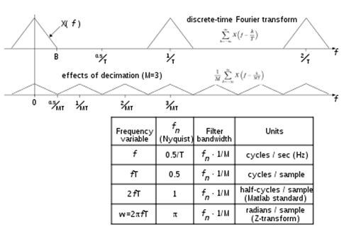

  • Hi Mark,
    The global chop feature effectively adds another layer of decimation to the processed data. You have correctly identified that this is approximately a factor of 4, which reduces the sample rate. Referring to the image below, decimation flattens the magnitude of the response and copies it by the decimation factor (this image shows a decimation value of 3, not 4 unfortunately, but the idea is the same). Then, the transform at 1/MT and 2/MT would be discarded, leaving just the response at 0 and 3/MT, which has the same bandwidth as the original signal.
    The Auto-zero mode can reduce the noise by a factor of √2 because the act of averaging two samples is similar to applying a lowpass filter (assuming the noise is Gaussian). But again, this does not change the frequency response or the noise bandwidth since the sample rate is changing at the same time.
    Ultimately, AZ mode does not change the noise bandwidth.
