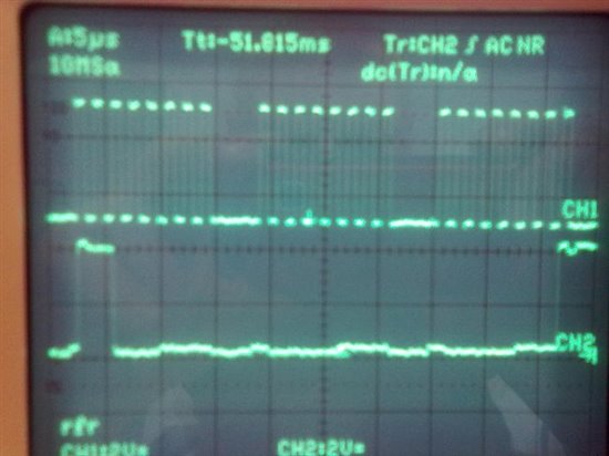

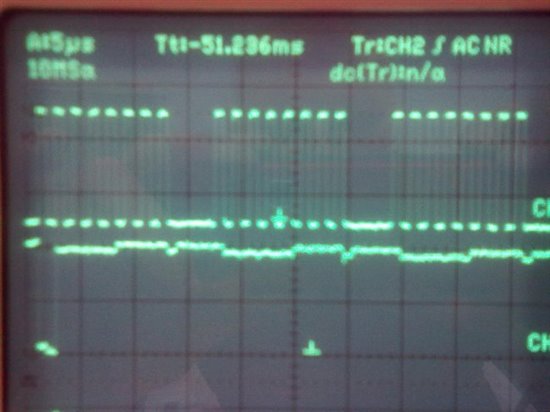

i use the ADS1298ECG-FE with the ATMEL SAM3U-EK and i have a problem to read the ECG data. I can read and write the register with my SPI but when i will read the channel data i only get 7FFFFF. I only use one channel and the other seven are powered down. So i connect the RA (channel 1) with a ECG simulator but nothing changes. I always get 7FFFFF the Vref voltage explained on page 27 of the datasheet. When the DRDY pin goes low i read out the 27 byte (3 byte status register and 8 channel). I get the following bytes:
1100 0000 0000 0000 0000 0001 status register
0111 1111 1111 1111 1111 1111 channel 1
7 times 0000 0000 0000 0000 0000 0000 channel 2 - channel 8
So the `0` for channel 2 -channel 8 are OK because i have them powered down but the channel 1 doesn't change. I´m using the continuous mode and wait a certain time and then i send the SDATAC and STOP command with my SPI. And during this time the data of channel 1 is always 7FFFFF. I use for the analog voltage 3.3 V and for the digital 2.5 V and the VREFP is set to 2.4 V in config3 register. I hope my power management is OK. The JP24 is between 2-3 and the JP2 between 1-2. I don´t know what i´m doing wrong because my SPI works and i get the data which i see on the oscilloscope. I have insert two pictures. You can see the SCLK and the DOUT of the ADS1298. The first picture are the first three byte (the status register) and the second picture is the next three byte (channel 1). I hope you can help me and tell me what i´m doing wrong.
Best Regards
Eckart

    Welcome to the e2e forum!  For the ADS1298 board, having JP2 shorted pins 1-2 and JP24 shorted pins 2-3 is going to give you a bipolar +/-2.5 (5V) analog supply.  For a unipolar 3V analog rail, the shunts should be shorting JP24 pins 1-2 and JP2 pins 2-3.  This might be part of your problem.  Do you get proper data from CH1 using one of the test modes or when reading temperature for instance?  Also, just an FYI really, but if channels 2-8 are powered down, you do not need to read them - this might save you a little overhead in your code.

    thank you for your fast answer. I have found the problem. The ECG cable between my ECG simulator and the ADS1298-FE was damaged. I changed it and now it works. But i have two new questions. When the channel 1 is set to the temperature sensor and i want to read out the temperature. How many byte must i get and what does this mean in voltage? How can i convert it to voltage to put the value into the equation of page 20 of the datasheet? And my second question is how to convert the data of channel 1 when it is set to a normal electrode into voltage. For example i get a value of FFFB7C and i can read the table of page 27 of the datasheet where FFFFFF = –VREF/(2^23 – 1) (-2.4V/(2^23-1) =-2.86E-7 V). What is FFFB7C convert to voltage? Or when i get a value of the channel 1 of three byte like 002F6E. What does it convert to voltage?
