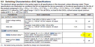

  4. Is there any provision inside the AMC7834 to make the bias voltage for the respective DAC port to 0V suddenly, we need this feature for the RX event

    1. The settling time for both AUXDACs and DAC outputs are the same.  They have similar AC behavior.
    2. These DACs can be used for any biasing, but the clamp mode only makes the AUXDACs go to GND.  The regular DACs have the VCLAMP inputs  for programmable clamp voltages.
    3. You can for LDMOS type PAs.
    4. The CLAMP functions are somewhat slow as the internal analog switch has some impedance.  We specify about 5µs for CLAMP functions.
    5. The latency updating the DAC is very short.  So consider the LDAC event starts with the rising edge of CS during an update command.  You can expect that to start slewing in a few hundred nanoseconds.  The real delay is the slew rate and settling time.
    6. The DACs and AUXDACs have the same update time.
