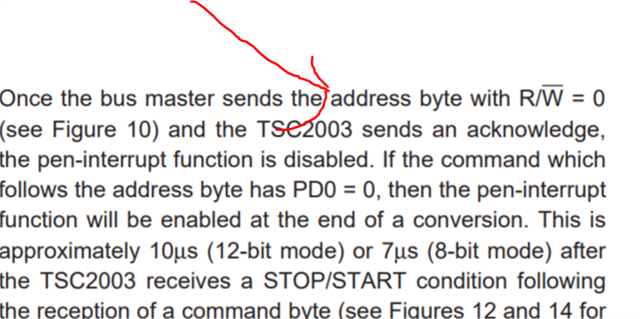

    Did you use Control Byte  0xC6 ? This chooses 8 Bit mode. 0xC4 is 12 bit mode
    The Text below is a snippet from the Datasheet. I cant say for Sure but this implies that for 8 bit mode the Databyte is not D11-D0 Split over 2 bytes but D8-D0 over 1 byte. Perhaps that is why you get an output from 0-255 on 1 Byte and 0XFF on the other.
    It might be an idea to to switch over to 12 bit mode just as a Test and then the 2 bytes might start showing values.

  • 1.Interrupt:
    If a command Byte has PD0=0 Then at the end of a conversion an interrupt is enabled. Touching the screen shall generate an interrupt.
    Touching the screen multiple times shall generate multiple interrupts. This continues till an I2C is sent to the device and device acknowledges.
    The interrupt is then disabled. It might be that you are not Writing to the device and the interrupt is not being disabled.
    2.The behaviour with 12 bit is strange. Normally a 12 bit read should have something on both bytes. I would suggest taking a look on I2C with a scope,
