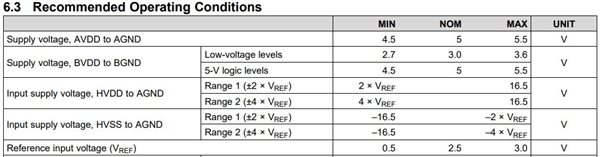

If we do not require bipolar performance can HVSS be connected to AGND to maximize converter resolution?
Hi 3fti,
The primary support engineer is on vacation now and I support you on her behalf.
The 'Power Supply Requirements' in the electrical characteristics table below on page 8 lists the required supply voltages for normal operation, otherwise you will not be able to achieve the specified performance in the datasheet.
Please refer to another post on the E2E forum: TMS320 WITH EXTERNAL SPI ADC
