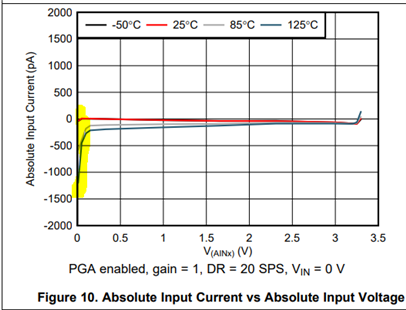

  • Hi Obata-san,
    Leakage current is a complex discussion.  When connecting the analog input to AVSS the highest leakage current occurs at high temperature with the bulk of the leakage current coming from the ESD structures.
    As an example, note the datasheet figure shown below that as the absolute input voltage is near zero and the ADS124S06 is operating at high temperature the leakage current is the highest.
    Also note that the current is less than 2nA.  As I already stated this is a complex topic and the graph also includes all leakage and currents for the device while sampling.
    Consider that all diodes have a reverse leakage.  Some ESD protection diodes can be 10 to 100uA of leakage current, so 2nA is many orders of magnitude less and is insignificant to the overall supply current required in the system.  If an ESD cell is connected to DVDD then the leakage would come from the DVDD supply.  For the analog inputs, the ESD cell is connected to the AVDD supply so the leakage current would flow from AVDD.
    There tends to be a lot of confusion regarding the recommendations in the datasheet regarding the unused analog input connections.  At room temperature notice that the total current is perhaps a couple of pA or less.  In contrast the higher temp leakage current is much higher but in the end is insignificant to the overall system current consumption.  Just to be clear, the leakage shown in the graph above happens at high temp, and is inconsequential to the overall current required by the ADS124S06 for device operation.  Total system leakage from switches, capacitors and diodes will be much higher than the ESD cell leakage current of the ADS124S06.  So although the current appears to be significant relative to the room temperature, the current is really not that great even in worst case.  So this should be a non-issue.
