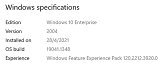

My system:

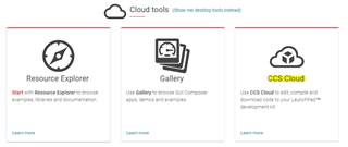

    Select CCS Cloud from the cloud tools menu on dev.ti.com:
    Upload the project by selecting Project >> Import CCS project. Select the TPL0501 folder in the download I shared and press upload.
    With the TPL0501EVM.ino file highlighted, click Run >> Debug Selected project.
    This DEBUG window will open (if it doesn't open, select the debug tab on the right side of the page) and click the blue resume button to start running the code.
    The TPL0501 configuration will populate automatically in the .json file as the debug starts.
    You can select Run >> Start without Debugging for future runs of the code. If you  make changes to the code (to change the tap positions) you will need to select Debug Selected Project again.
