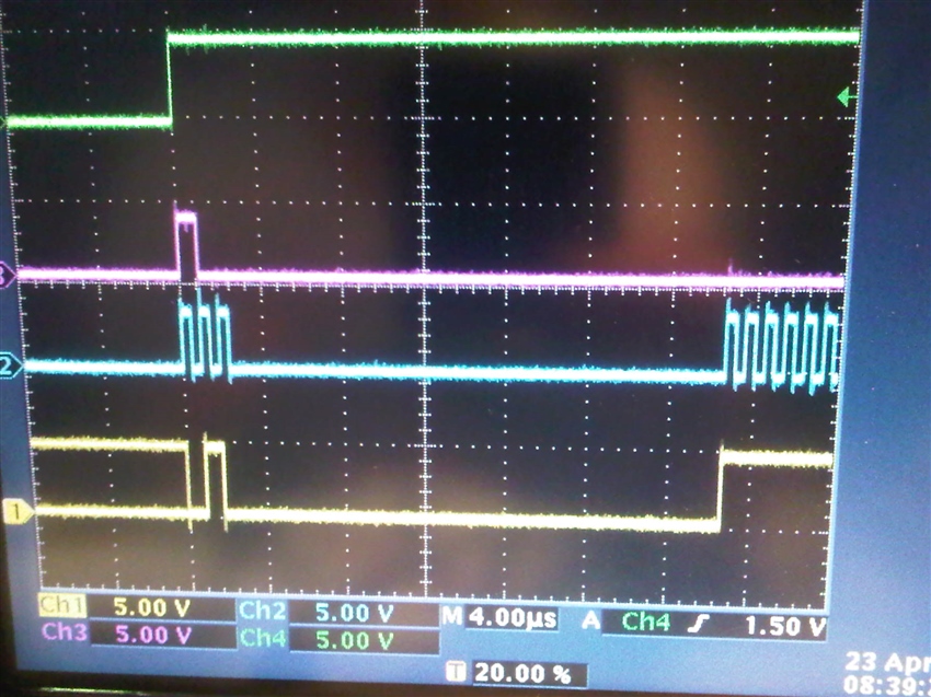

    Here is an example of running the ADS8363 in Mode IV using an MSP430F2013 - perhaps an unconventional way to run the part, but it seems to be working.  The F2013 has the USI port which allows you to control the number of clocks per transfer.  I've set the device up to run one set of 3 clocks and a second set of 16.  I've also used SIMO as the input strobe for RD+CONVST by writing 0x8000 into the shift register.  What that does is shown below:

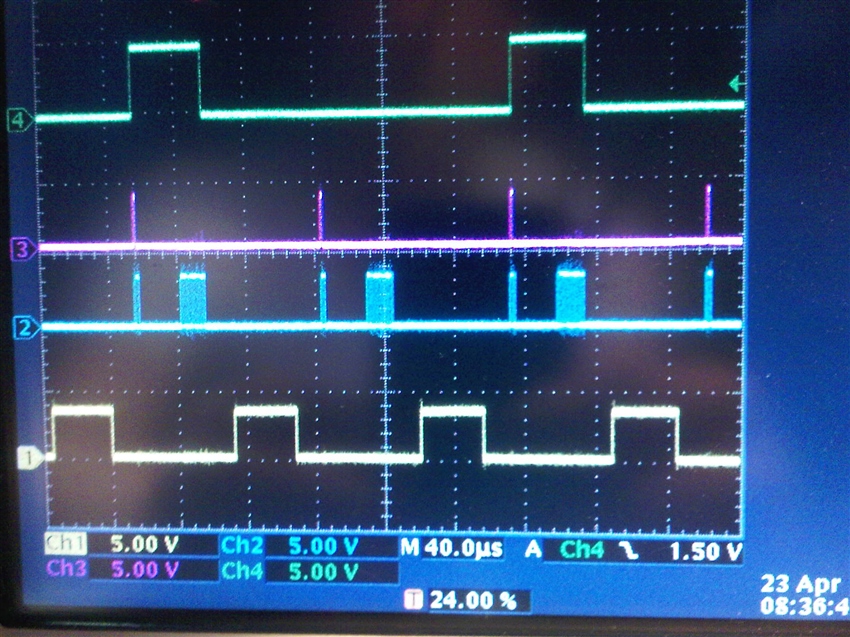

    The SIMO output connected to the RD+CONVST input (by writing 0x8000) puts a logic high on the combination of those two pins that is one clock cycle wide.  This starts the conversion process and the second two clock cycles hold the channel ID bits.  In the code, I simply store the two bit result in a variable called CHID.  From there, a second series of 16 clocks is generated by putting 0x0000 into the shift register - the SOMI pin of the F2013 captures the conversion result during this phase.  The traces above are (from the top) BUSY, RD+CONVST, SCLK and SDO - the channel ID bits in this instance are '10', indicating the data to follow is from channel A1.  The screen capture below shows the overall cycle.  You will note that the BUSY is only going high with every other application of the CONVST pulse.
    In the sequence above, the top trace is BUSY, followed by RD+CONVST, SCLK and finally the /CS input.  Let me know if this helps - I've attached the code for the MSP430F2013 as well - this was run on the free version of the IAR Embedded Workbench software along with the EZ430-F2013 hardware.

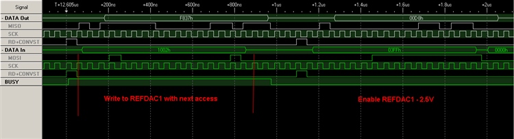

    Here is another screen shot that is more consistent with the ADS8363 capabilities:
    This is a simple write to the part to enable the DAC.
