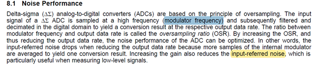

as mentioned in ADS114S08 datasheet, the increasing of OSR, will help to improve the noise performance of ADC

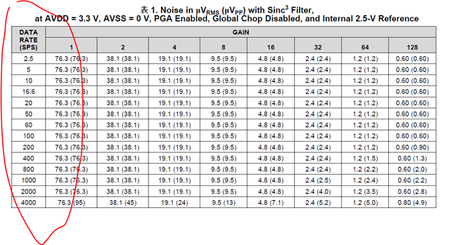

but in its datasheet noise value table, the noise rms and peak to peak value are not changed as OSR increase, please see below table
    The ADS114S08 (16-bit) has similar AFE performance as the ADS124S08 (24-bits) and so the noise of the ADC is dominated by the quantization noise of the ADC resolution, not the modulator/front-end noise and therefore the noise does not scale with data rates.  With a 5V reference, 5V/(2^24) = 76.29uV.  With a PGA G=128  -> 5V/(128V/V*(2^24)) = 0.596uV.

    thanks for your answer,
    so you mean quantization noise is not impacted by the OSR?
    the 76.29uV is input referred noise ,right? then how to calculate output referred noise?
    thanks a lot
    Yes, the quantization noise is based on the resolution of the ADC core, which is 16-bits and it is therefore not impacted by OSR.
    You'll multiply the input referred noise by the gain to get the output referred noise. With G=1 the input and output-referred noise values are equal.
