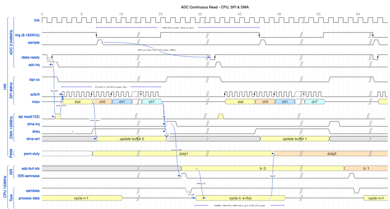

    I have created this timing diagram including both the hardware and software of the system, using 'wavedrom.com'. Does it look sane?
    The output is an integer to 'pwm-duty'. Please note SCLK is only showing every fourth clock pulse, and the adc data is double buffered, and the dma unit can be triggered from the drdy pulse and can dynamically reconfigure itself.
  • Hello Ruth,
    The ADS130E08 uses a delta-sigma ADC architecture. The sample-and-hold capacitor circuit is sampled and integrated over time. The result is a bitstream output which passes through a digital decimation filter. A high-resolution result is available from the digital filter at the data rate frequency. This ADC architecture is different than a SAR ADC, which converts the sample-and-hold voltage into a digital result with every conversion.
    The tSETTLE timing spec refers to the initial settling of the digital filter when conversions begin (i.e. START pin transitions from low to high). However, when there is a step change in the channel input voltage, this transition will appear in the ADC output after 3 data rate periods have passed (i.e. the fourth DRDYn falling edge indicates fully settled data).
    The RDATA command is used to update the output shift register with the most recently completed ADC conversion data on-demand. This is intended for applications which cannot read from the device at regular intervals and do not monitor the DRDYn interrupt. In RDATAC mode, if the host controller cannot finish reading the data before the next conversion is ready, the new data will immediately overwrite the previous conversion and the results will be corrupted. Using the RDATA command, the host controller can always read the most recent conversion reliably, but the risk is missing a sample.
    Ryan
