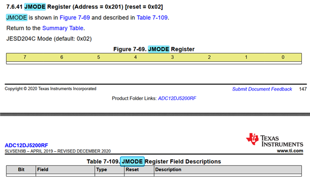

I’m working with an ADC12DJ5200RF and according to step 6 in section 8.3 the JMODE shall be programed to the desired JMODE. The problem is that the tables for the register map of the JMODE is blank in the latest datasheet, see picture below. Can you please upload new correct version or share the correct tables?

    Sorry for missing info. We will update the datasheet to fix this issue. Here is the description of the mode table
    JESD204C Mode (default: 0x02)
    [7:0] JMODE
    Note 1: This register should only be changed when JESD_EN=0 and CAL_EN=0.
