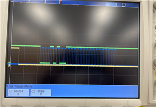

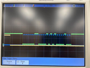

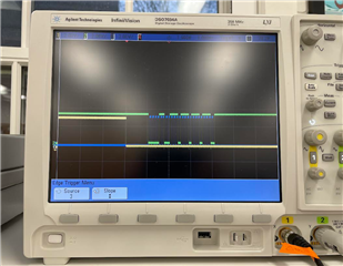

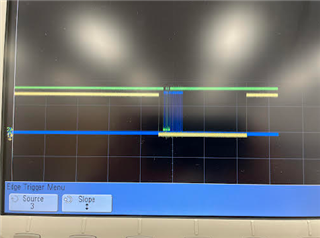

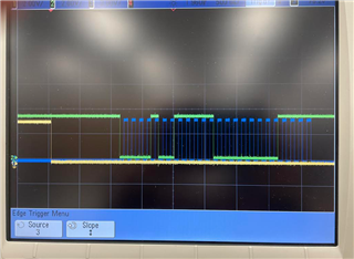

    I used an oscilloscope to see my SPI output (CLK = blue, MOSI = green, CS = yellow)
    SPICONFIG = h030A84
    DACPWDWN: h09F00F
    DACRANGEn: h0CEEEE
    DAC0: h14FFFF
    The oscilloscope readings seem to match the messages according to me. Something I notice is that CS stays low for a significant amount of time after the
    MOSI has finished sending its data bits. I don't know if this is normal.

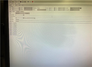

    Next, I connected the MISO pin like you suggested and tried to read from some of the registers. I don't think it really worked haha. These are the codes for the read messages I used:
    DEVICEID: 810000
    STATUS: 820000
    SPICONFIG: 830000
    GENCONFIG: 840000
    I creates these codes with this general format: 1b (read bit) + 0 (don't care) + 6 bit slave address + 16 don't care bits.
    The image below shows the responses I got to my read requests. The return messages didn't make sense, so I assume I didn't send the appropriate read
    messages.

    I didn't catch that you were using the Analog Discovery 2 as your SPI controller. Your connections look ok from what I can see in the picture. Can you confirm that you have the ground of the microcontroller on the left connected to ground on your breadboard? Maybe that is where the green wire is going.
    There is a minimum time from the last SCLK falling edge to the CS rising edge, but there is no maximum time that would indicate that the long delay you are seeing is an issue. It looks to me that the data is changing very close to the falling edge of the SCLK. The DAC reads the data on the falling edge, so the controller needs to update it on the rising edge. Try changing the you SCLK phase in the protocol analyzer to 1.
