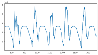

I'm measuring ECG with nRF52 and ADS1291.
Currently, the data is coming out as below, and we measured it with our wrists and fingers.
Is there a problem with the setting?
CONFIG1 : 0x06
CONFIG2 : 0xF8
REG_LOFF : 0xFC
CH1SET : 0x60
RLD_SENS : 0x2C
LOFF_SENS : 0x0F
REG_RESP1 : 0xEA
REG_RESP2 : 0x03
GPIO : 0x07

    Thanks for the post. I reviewed the register settings and please see some comments below.
    1. Operating the device at a data rate of 8 kSPS and PGA_gain = 12 will introduce more noise into the system. Based on your design requirements, you can refer to Table 5 - 8 for system noise optimization.
    2. The RLD sense should be connected to IN1P and IN1N since channel 2 is not used for ECG sensing. Set RLD1N and RLD1P to 1.
    3. If not used, you can disable the internal oscillator output to the CLK pin by setting CONFIG2.bit3 (CLK_EN) to 0.
    4. Turn off the respiration block if not used. Set both RESP1.bit6 (RESP_DEMOD_EN1) and RESP1.bit7 (RESP_MOD_EN) to 0.
    -TC

    We conducted various tests referring to your answer.
    And the same data as the picture below came out.
    But if you look at the waveform, it's not a normal ECG waveform.
    I don't know what part I missed.
    Can you help me?
