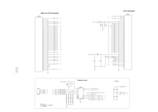

Hello TI experts,
My customer tests TSC2007 with their product now, but there is a problem.
when they touch left of the screen, it works well. but if they touch right of the screen, it points more left than I touch.
I attach a video link for your convenience. (you can see it after 10 seconds of this video.)

I also attach a schematic. could you review it?

  • Dear Sanjay,
    Thank you for your support. I attach a schematic in PNG file below.

  • To a first look the schematic looks fine.
    Unfortunately Our firewall does not allow me to see the video. Can you please elaborate in words the exact issue
    that you see. I will then try to guide you

  • i saw the video . It looks as if if a touch is detected anywhere on the right of the screen.
    As a first step i would suggest to disconnect the transient suppressors on the 4 pins and to recheck behaviour.
    As a second step i would suggest to send the command to measure X position. This makes X+ 3.3V ,X- 0V and Y+ is fed to the ADC.
    They should put an CRO on X+,X- and Y+. When x+ is 3.3v,X- =0 y+ is a DC Level that goes from 0v to 3.3v as we move finger from left to right.
    They should check this on a CRO

    first of all they removed all transient suppressors -> same error / change ferrite bead to 0 ohm resistor -> same error.
