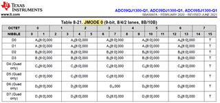

question: In  FPGA, customer wants to de-map the received data whose format is:  rx_tvalid、rx_tdata[255:0]、rx_start_of_frame[3:0],  rx_end_of_frame[3:0]、rx_start_of_multiframe[3:0]、rx_start_of_multiframe[3:0].  7z100's  user clock is  rx_core_clk, and one clock corresponding to 256 bits(rx_tdata[255:0]).
how can we map the different lane's data to rx_tdata[255:0]!  even with the explanation on page 79,  Table 8-21 of theADC09QJ1300-Q1 datasheet, we still don't know how to do the mapping.

    Can you please have the customer change the output data mode on the ADC to Transport layer test pattern and then generate the ILA data from all 8 LANES and share the data with us and then it will be easy to explain the mapping.
    To enable the transport layer test pattern do the following register writes.
    Address VALUES
    0x200     0x00
    0x205     0x05
    0x205     0x01
    Neeraj
