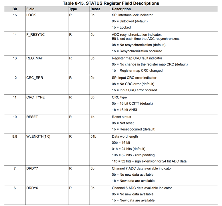

  • Hello nkumar,
    This is pretty strange. You haven't configured the mode register right?
    If I translate 0x28FF, the most confusing part is the Data Word length. It looks like you're clocking for 24 bits, but it expects 16 bits. I might be wrong, feel free to correct me.
    The only way this is changed is from the MODE register (addr:0x2) is changed. It would explain the reg map CRC indicator.
    Can you initiate a RESET command using the pin (or in software if you feel confident) and then repeat the read command?
    As a sanity check, you should check that there's no issues with your read command by reading the ID register to make sure you're reading the correct value? It does look like your protocol is good though, the timing is what I expect. But its always good to do a sanity check.

  • Hello nkumar,
    What is confusing, is that sending NULL should respond STATUS reg values, not 0x28FF. I can't figure out why it is stuck on that value.
    In my previous post, I assumed that 0x28FF is the register value. The values are irregular but not so incorrect that I can pinpoint the issue. In other words, I can't prove your SPI frame formatting is an issue from the previous post.
    If we want to prove that you can successfully communicate with the device, please read ID register.
    0x28FF:
    With that being said, I just realized you are receiving 0xFF2800, not 0x28FF00, according to your logic analyzer shots. From the datasheet:
    The MSB is clearly 0xF from the logic analyzer. This makes me think that something is very wrong in the construction of your SPI frame.
    For a very basic question. Are there any other devices sharing the SPI lines? As in, are the MSIO and MOSI lines only connected to the ADS131M0x and your microcontroller? I noticed the nCS line (assuming it is labeled SS in the logic analyzer shots) is tied to GND.
