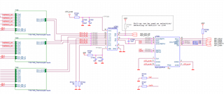

We have 32 inputs, sets of 4 are muxed by an 74HC4052, these 3 are then muxed by another 74HC4052 and fed to a ADS1220 (we have 3 of them) on channel 1, channel 2 is used for cold junction measurement.
(the reason of the second mux is because the original design used an 8ch ADC).

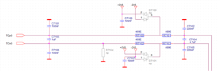

Our input circuit:
The ADC:
Upon inspecting the input signal when the TC is shorted we can see that the BCS is enabled for 550us and than shuts down. For debug purposes we fooled around with the time that the BCS is enabled, but we concluded that it will always disable after 550us, shorter is possible though. The green trace is the moment that the MCU enables the BCS (in this case it should have been 630us (as i stated above our target was 1ms but we changed this for debug purposes).
