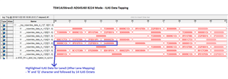

  • Is SYNC ever going back high? If not, see if you can toggle this manually and see is the ADC starts sending the ILA data. What configuration files are you using for the ADC EVM? Make sure to press the hard reset on the ADC EVM after the LMK config file has been loaded and before loading the ADC config file.

  • Is Chipscope showing any ILA data?
  • What should I see for the ILA, if I turn turn on the JESD test pattern with the GUI I still just see the bcbcbcbc.

    There are some bugs with the GUI. I would stick to just using config files. I would expect the ADC to start sending ILA data as shown in attached file right after SYNC goes high. I am checking with our firmware team to see if they can generate a project using the VCU118 with the ADS54J60EVM.
