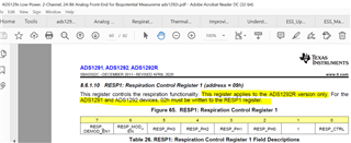

    According to "ADS129x Low-Power, 2-Channel, 24-Bit Analog Front-End for Biopotential Measureme ads1292r",
    This(RESP1) register applies to the ADS1292R version only. For the ADS1291 and ADS1292 devices, 02h must be written to the RESP1 register.

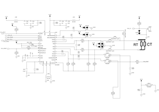

  • As shown in the figure, RT is the resistance and CT is the capacitance. I used ADS1292 to measure the impedance of RT in parallel with CT.For example, when RT=100 ohms, CT=1nF,ADS1292 reads 100 ohms,But when I changed the capacitance of the CT to 47nF, I read 9 ohms.Because the ADS1292 measures impedance using a square wave modulated a sinusoidal wave method.The phase difference between square wave and sine wave will affect the measurement result.Different capacitance values measured will result in different phase differences.The ADS1292 can only initially set the phase difference to a fixed value through the RSP1 register.You can't calibrate the phase difference by yourself. Is there any way to solve this problem?Thanks.

    The respiration function may not suitable for such low/small impedance measurement as human body impedance is much higher.
    Could you try some pure resistance(e.g. pure 2k or 3k ohm or larger resistance) first, and then try some parallel RC combination that can yields larger impedance with respect to the selected frequency, e.g. impedance 2k to 15k ohm, as mentioned in the page 63 in https://www.ti.com/lit/ds/symlink/ads1292r.pdf?ts=1649786937114&ref_url=https%253A%252F%252Fwww.ti.com%252Fproduct%252FADS1292R
    "Standard requirements are respiration impedance values ranging from 2 kΩ to 15 kΩ, modulation clock frequencies of 32 kHz or 64 kHz, and noise levels of less than 10 µV"
    Also, page 63, https://www.ti.com/lit/ds/symlink/ads1292r.pdf?ts=1649786937114&ref_url=https%253A%252F%252Fwww.ti.com%252Fproduct%252FADS1292R
    "When the modulation frequency is 32 kHz, gains of 3 and 4 and phase of 112.5° and 135° are recommended. When the modulation frequency is 64 kHz, gains of 2 and 3 and phase of 135° and 157° are recommended for best performance."

    The device was designed for respiration impedance, letter R stands for Respiration; not for general human bioimpedance.
    Could you try the following to see if the measurement work properly in the range specified in the datasheet -
    Could you try
    some pure resistance(e.g. pure 2k or 3k ohm or larger resistance, potentiometer) first, and then try
    Also, small impedance may incur large current that's out of the spec that could damage the device.
    Side note, for good general bioimpedance measurement, you may want to try tetrapolar bioimpedance measurement.
    You may also take a look of ADS1298R to see if it fits your need.
