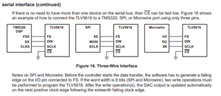

I would like to use a TLV5616 in a design and am wondering about three things
1) is it necessary to use the FS to initiate a write sequence or can I leave this pin low all the time?

    1) It looks like it is more important for FS to be pulled low and high based on the highlighted sections:
    FS can be used as the CS and CS can be tied low. The device will operate in 3-wire mode.
    Just make sure the timing requirements are met for FS:
