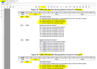

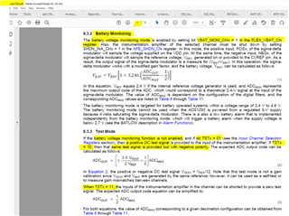

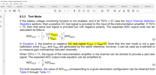

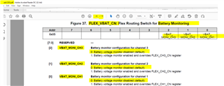

    According to "ADS1293" datasheet -
    To enter/enable Test Mode, battery voltage monitoring function needs to be disabled and bit TSTx set to = 01

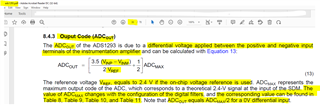

    ADC_MAX represents the maximum output code of the ADC, is dependent on the configuration of the digital filters, and the
    corresponding ADC_MAX values are listed in Table 8 through Table 11.
    You will need to do some algebra(move numbers around both sides of the equal sign) to obtain the differential inputs voltage, i.e. (V_INP - V_INM).
