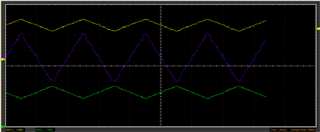

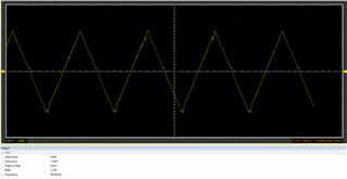

  • Thank you for your anwser Chase.
    To detect the glitch with more visibility we are using ramp signals, frequency = 500 KHz. The amplitude doesnt matter because the glitches always appear in the same places. You said "Also, is this something you are seeing on a single device or is this across numerous devices" To answer your question, we are testing on 3 different boards (devices) with the same hardware and each of one give us the same result
    This is the DAC outputs with CONFIG1 = 0x0D. (DA = green ; DB = yellow)
    This is the DAC DB output with CONFIG1 = 0x09, the glitch is more visible.

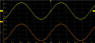

  • Hello Juan,
    I have taken some measurements using the DAC5688 EVM with the clocking setup you have described above.
    • Clk1 - Single Ended, 250MHz
    • Clk2 - Differential, 500MHz
    I generated a 1MHz sine wave and sent it to the DAC using HSDC Pro and I am not seeing any glitching like you have described. Shown below is the outputs I measured, output channel A is shown in yellow and output channel B is shown in orange. Additionally, changing this inv_inclk bit has no effect on the output signals.
    It could be possible that for your application, some other aspect of the design is affecting the output. Below I have included the register config file that I used for your reference.

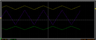

  • Hi Luke,
    We tested your register configuration and the result still the same. The yellow signal is CHA and green signal is CHB.
    This is our DAC schematic. To test the single mode (CLK1) we removed C226 and R234 so the pin (CLK0/CLK1) is floating. Additionally the C230 value is 1nF.

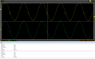

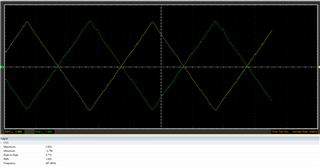

  • Hi Luke, this is the output taken of DAC pins, the previous images showed signals with higher amplitude because of the HW after the DAC.
    The yellow signal is IOUTA1, green signal es IOUTA2 and purple is (IOUTA1 - IOUTA2)
    The yellow signal is IOUTB2, green signal es IOUTB1 and purple is (IOUTB2 - IOUTB1)
    We are seeing the glitch on output A. Can you say to us if any thing is wrong on DAC schematic?
    Juan Camilo Peña A.
  • Hi Juan,
    I see no issues with the portion of the schematic you sent me. I am thinking something else on your board may be causing this. Lets try to get a sine wave working first. If you try outputting a sine wave and increasing/decreasing the frequency, how does the glitch change? If you connect the output to a spectrum analyzer when outputting a sine wave, do you see any spurs that are not harmonics? This could help us determine if the glitch is being caused by another signal combining with the output signal of the DAC.
