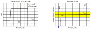

Customer inquires DAC7621 slew rate, could you support? Is the slew rate 7usec per 1LSB?

Hi Ikeda-san,
The slew rate for this device is not specified. The device will settle to ±1 LSB within 7us. This is the time it takes the output buffer to respond to a step change and settle into the defined error band of ±1LSB of the final value (or 0.02%).
These two typical plots show the rise time. The second plot is a zoomed in and shows the output reaching the 1LSB error band at around 7us.
