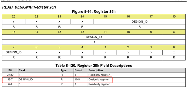

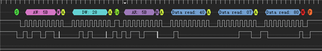

1. The Register 28h is fixed: 0x400780 (bit19-bit7=00000000011b). It is not match the manual description.
Above is my reading chronogram.
