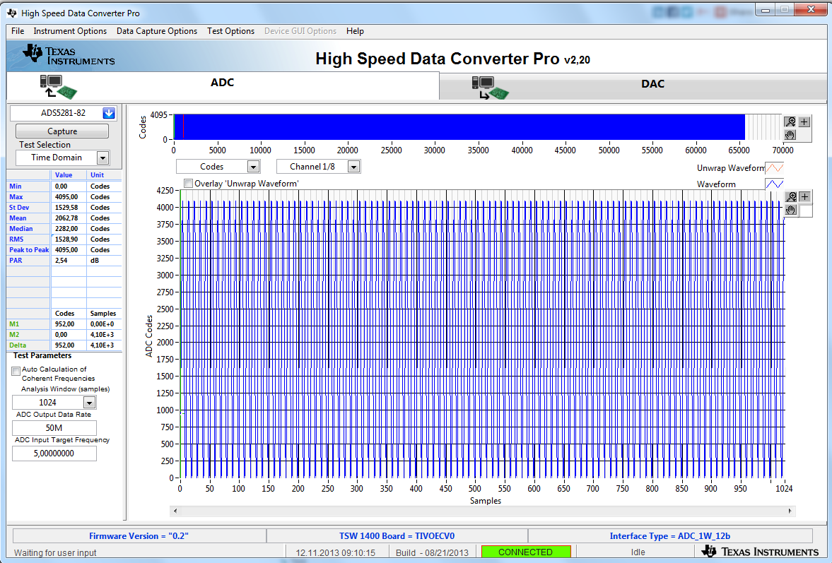

    I have a problem with the max. Voltage Peak to Peak with my ADS5282 EVM.
    My System is a TSW1400 and a ADS5282 EVM.
    As mentioned above is the max. Voltage peak to peak  2V with the internal reference.
    But if I plug a Signalgenerator with Output Impedance of 50 Ohm and a Voltage of 1.7 Vpp Sinus, then I get from the ADC Codes from 0 to 4096.
    Is this a configuration Problem ?

    Can you turn the signal level from the signal generator down to a level that does not hit + or - full scale, and is the captured signal spectrum celan after that?   I am looking at the bill of materials for the build of the ADS5282 EVM and it looks to me like the input transformers are 1:1 ratio, but the definition of the 'footprint; of the magnetics is a part number for a 1:4 ratio transformer.  If a 1V peak to peak signal just fits under the ADC full scale, then there could be a voltage doubling in the magnetics.    Or, maybe more likely, there may be a miscommunication on fullscale definition for our input voltage.  Our full scale definition is 2.0V peak to peak, differential.  That means that each *side* of the differential signal has a 1.0V swing.   When you see 1.7V peak to peak, are you looking at the swing of the single ended signal coming into our EVM before the transformer?  Or do you see 1.7V peak to peak using a differential probe across the differential signal after the transformer?  Or do you see 1.7V peak to peak looking at one side of the differential signal after the transformer?  If it is the latter, then this would be a 3.4V peak to peak signal differential into the ADC and our ADC would clip.

    When I turn down the level (< 1.7 Vpp) then i got smaller Values an the hit + or - are don't reached.
    I measured with an oszi, a differential signal level after the transformer of 1.7 Vpp, when I plug in a Signal with a level of 1.7 Vpp, so the transformer must be ratio of 1:1 .

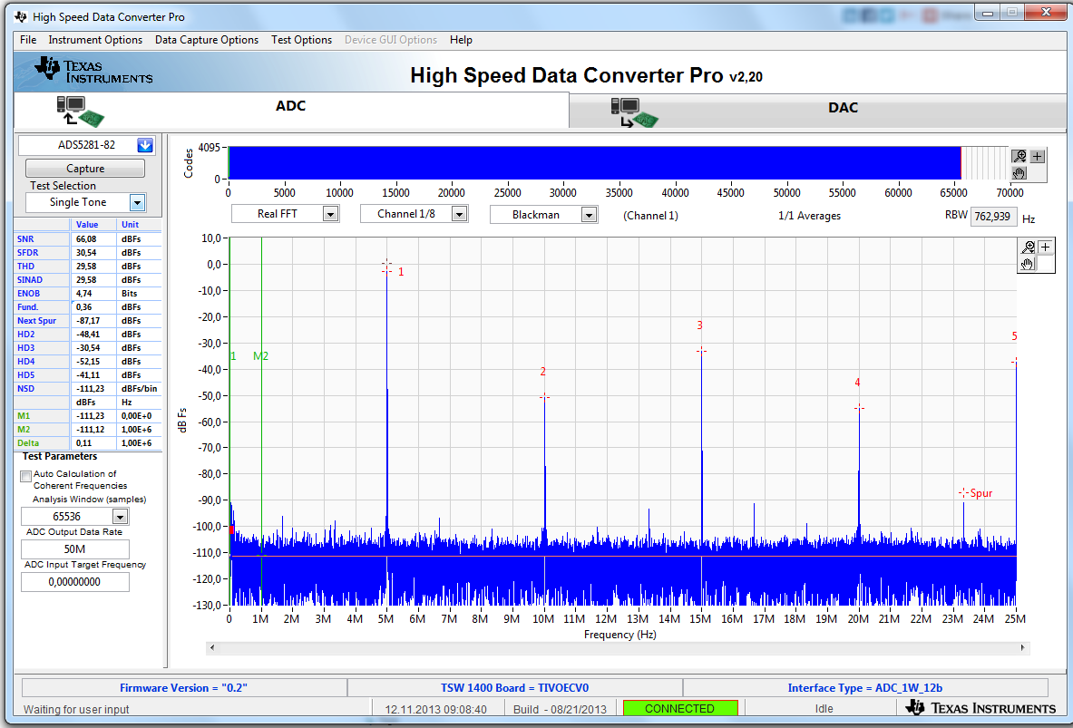

    The measured sprectrum got a high peak at the plugged frequency (e.g. 5 MHz), an some small peak's at the harmonics.
    The second picture is with a level of 1.7 Vpp from the signal generator.
