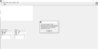

GUI is not working for us after installing the package. Kindly let me know how to resolve this issue.
Error message:
The VI is not executable. The full development version of LabVIEW is required to fix errors.
Kindly help here.

HI Diwaker,
I was able to find out some information regarding this error from the National Instruments website, and I have posted the link below for reference. Apparently this error sometimes occurs when a PC has an outdated version of the .NET framework on the PC. The website suggests to update the .NET framework from Microsoft's website. Please let me know if this clears up the issue.
'This VI si Not Executable' Error
In this case, you should install both .NET framework 2.0 and 3.5 from the microsoft website.
