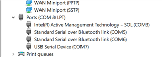

Hi ChienChun,
The compatibility is Win 7 mode.
Please see
The ADS1292EVM cannot be recognized, see COM7
Matthew

Hi Matthew,
Looks like the GUI can't find where you have a folder, or couldn't create one.
Could you verify that the folder in the error message exists? Is it a protected folder with no write permissions?

Hi Nick,
There is no such information after creating a 'saved' folder in the path manually.
Then how can I get the usb port recognized?
Matthew
Hello Matthew,
One common solution is to disable driver signature enforcement. Please perform that action and let me know how it goes.
