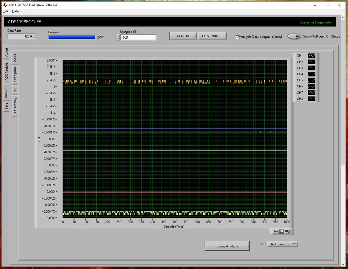

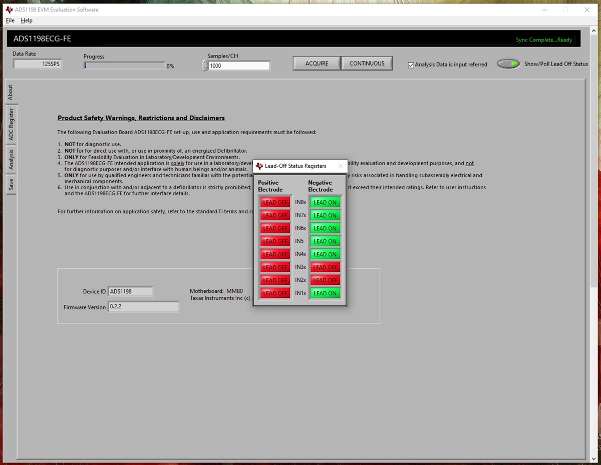

When i connect the EVM without any Electrode probe at J1, and if i check lead off it shows
Lead Off status
and the Data rate is 500SPS and 1000 samples/Channel.

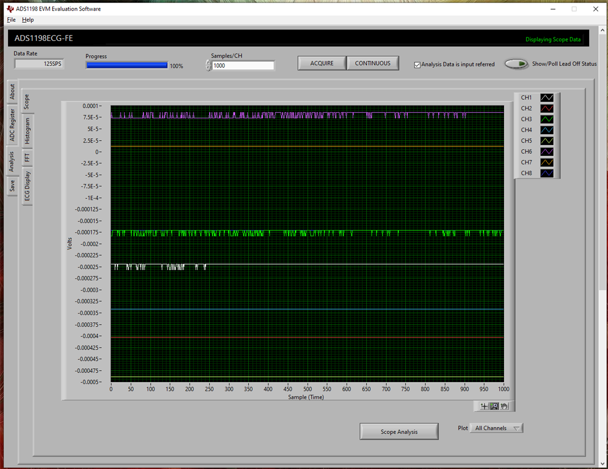

So as soon as i click Acquire.
The data rate goes to 125SPS and 1000samples/channel remains same.
After data acquired, and if i see in analysis, scope it shows.
Scope
This is what is see. seems nothing in this.

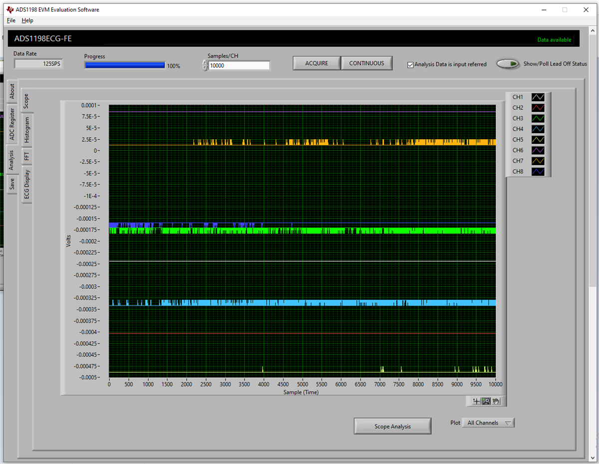

After i connect the Electrodes through Simulator.
the lead off detection shows
Lead off
and the signal on the scope at 125SPS and 1000 sample/channel.
With probe
This clearly shows no information.

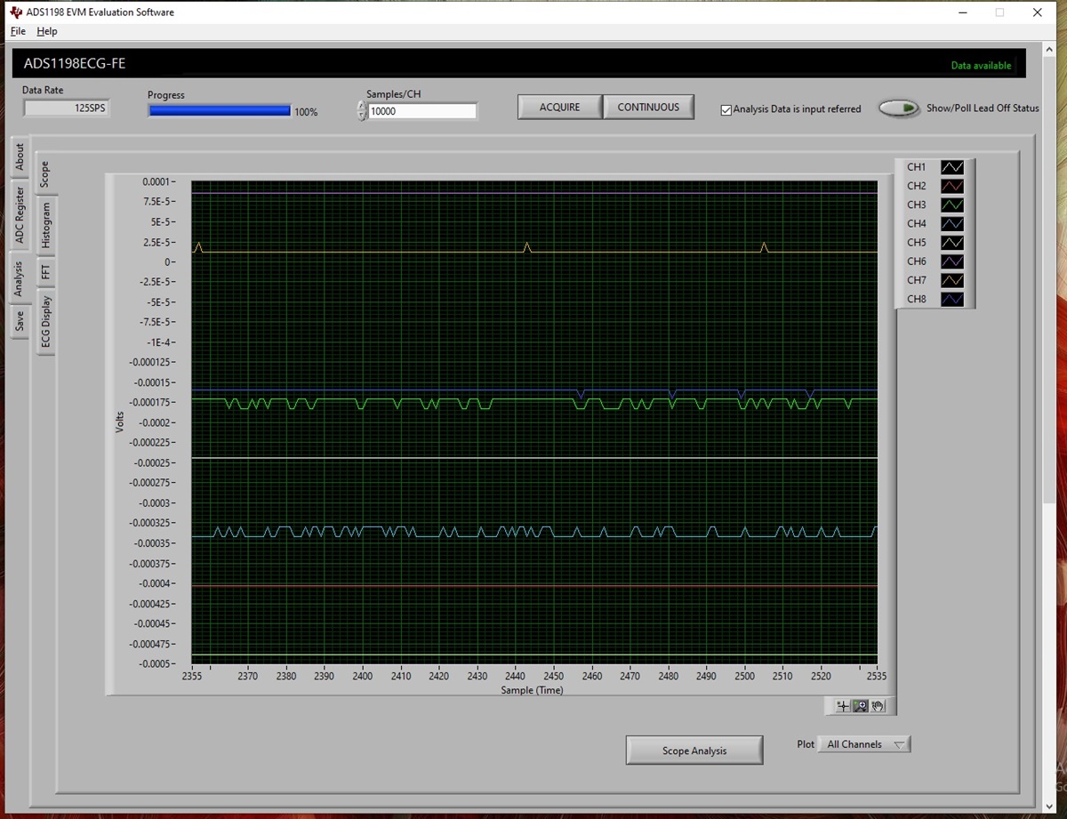

also i tried to see the signals by changing 10000 samples/channel.
This also donot have any information.
at 10000
and if i zoom out the signal

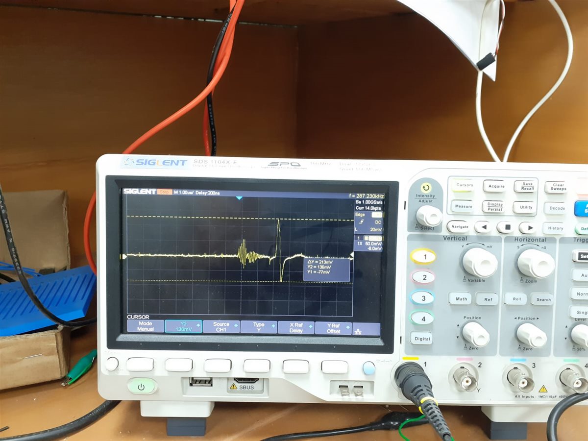

If you have doubt that my simulator is not working then i have checked it on CRO. i was able to get signals.
Simulator
So, is there anything that i am doing wrong, kindly help me out.
I have minimized the variables but yet i am unable to get the data ECG signals on my GUI.

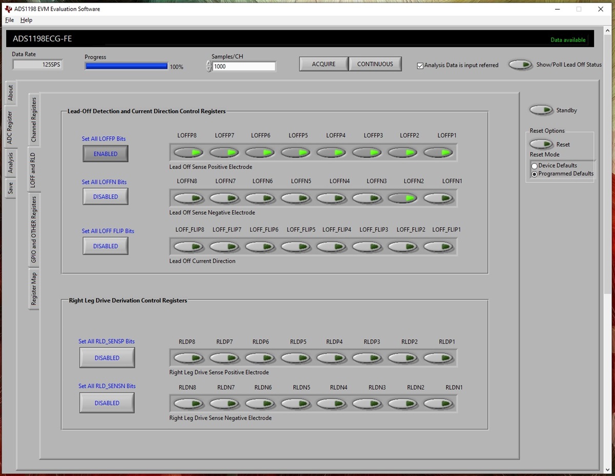

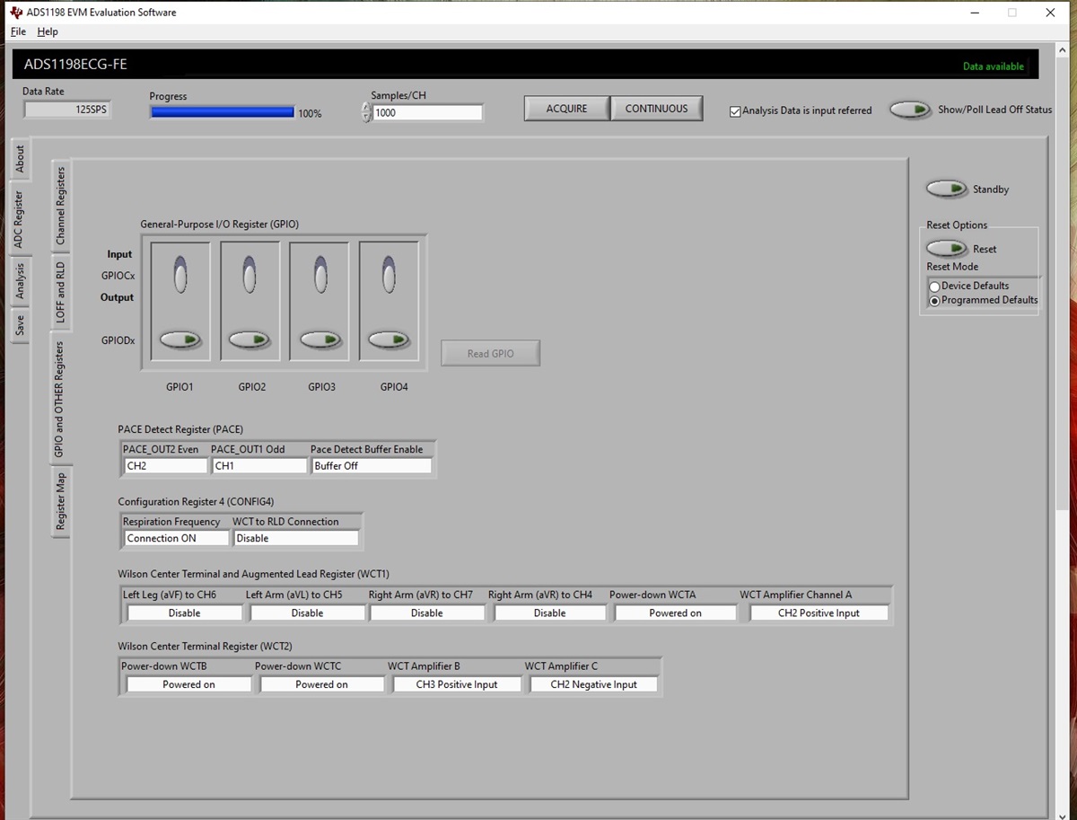

  • Hello md adil,
    Could you share your register configuration and settings pages? This would help us check if something was configured incorrectly.
    Kind regards,
    Nick Z
    So, i believe upto here there was no issue !!!

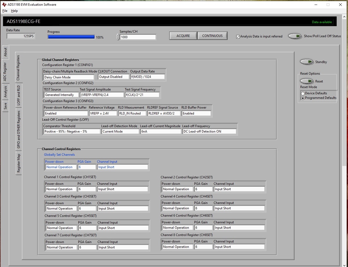

    Here are the Register configuration and setting pages you asked for.
    Kindly let me know if anything is required.
  • Hi md adil,
    Your inputs are currently all shorted. When inputs are shorted, they won't be taking in any signal. Please switch them to "normal electrode" if you'd like to be receiving a signal on those channels.
    Kind regards,
    Nick Z

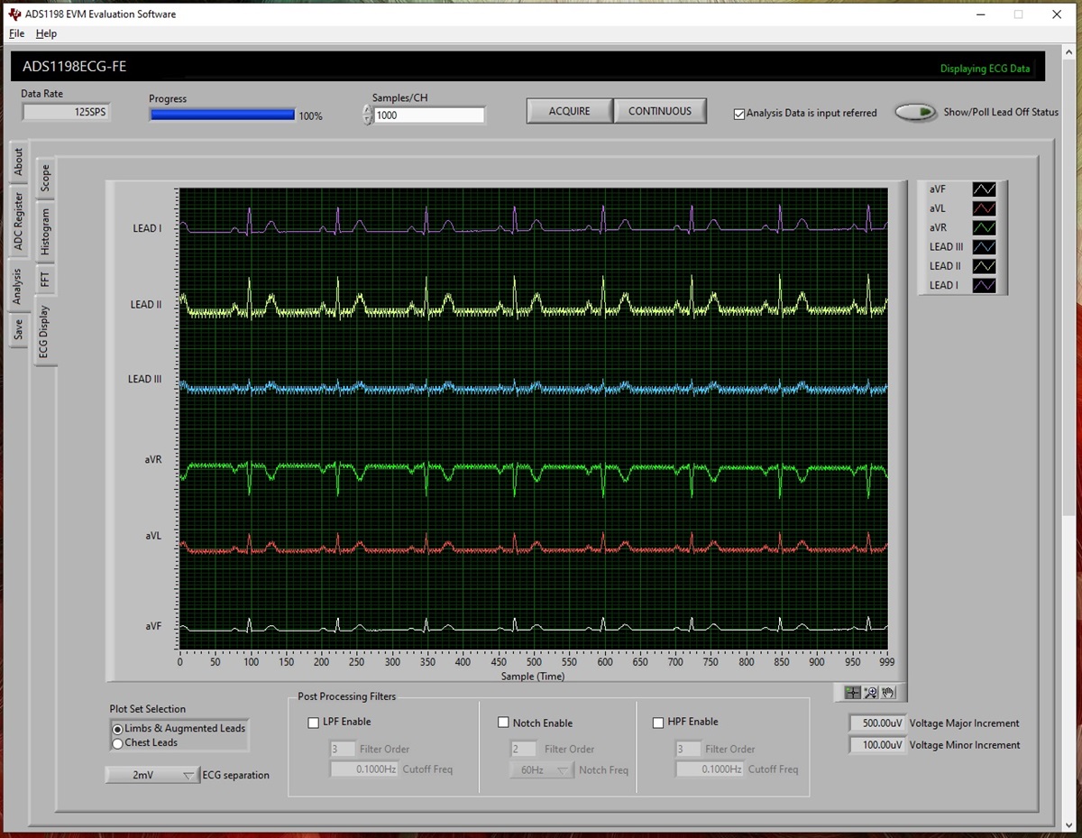

  • Okay, So i got it the output by Configuring the Channel Input control in Globally Set Channels to Normal Electrode.
    My Eval board, Electrode and the simulator all are working fine.
    So, it says that
    By default, the EVM powers up with the individual channels to an internal short with a data rate of 500SPS
    and a PGA gain of 6. Once the Acquire button is pressed, the Scope Analysis should reflect input referred
    VPP values less than 5μVPP.
