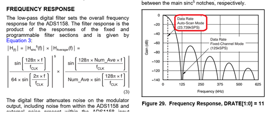

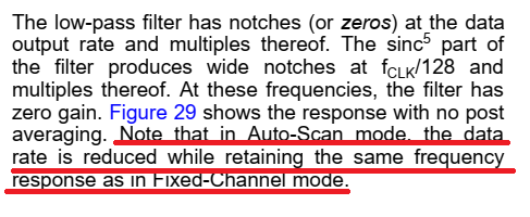

    First, there is no sinc1 response filter described in the datasheet.  Also, in Figure 29:
    The auto-scan data rate is shown on the sinc5 digital filter response.    The text also says:
    So, I think a sinc1 filter is probably not present.  Thoughts?

    This is kind of a complicated part as there is a sinc5 followed by an sinc1 averager.  What actually happens depends on fixed channel or auto-scan mode selection, CHOP and DLY settings.

    I'm not quite sure here what you are asking for here.  Delta-Sigma ADCs are oversampling and there is always some latency involved.  For a sinc5 digital filter, the data requires 5 complete conversions for valid data and thus the lower data rate when using auto-scan.
    The digital filter output response will follow the sinc5 response in the graphs.  The averager that follows is a sinc1 response.  For the 23.7ksps, the averager is set to 'no averaging'.  The auto-scan mode does all of the work for you in the end and removes the overhead of manually communicating for the mux switching, restarting the conversion, and monitoring the DRDY for a single channel result after 5 conversions periods.
    I hope that makes it more clear.

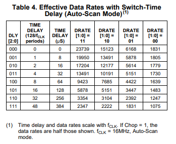

    In Auto scan mode, if we are utilizing all 16 channel, and lets say I am using 8usec time delay, no chopping, and 4 averages, with this config, let's say I am getting around 800/900 samples per second data rate. Can we accurately capture a 5 kHz sine wave on one channel ? What parameter will tell us if can get accurate capture or not?
