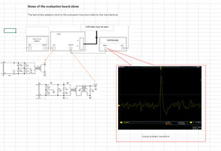

DAC3171: Does spike noise occur structurally?
Part Number: DAC3171
I evaluated the DACs of other manufacturers. The result was unacceptable regular noise glitches. After checking with the manufacturer, there was a reply that the automatic calibration function periodically generated noise of several millivolts. Does the DAC3171 have a built-in function that causes such glitches
