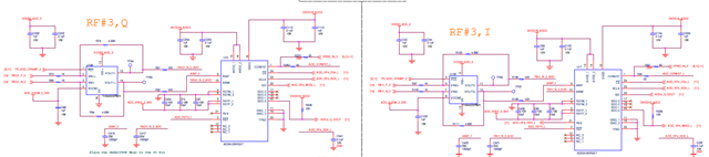

My customer is working on one of the medical equipment and facing data corruption issue while using ADS9120 in the daisy chain mode (two ADC’s), below is the snapshot of the schematics for your reference:

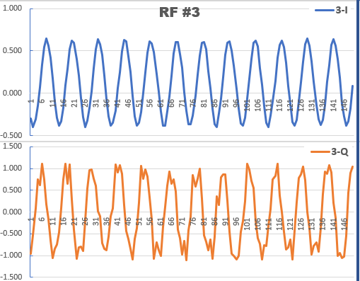

And below is the data which they get out of the the device.

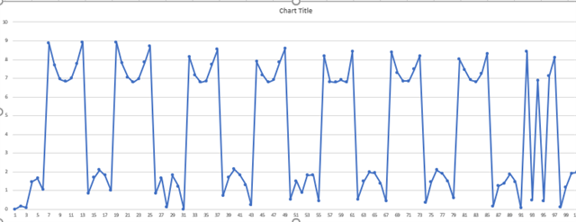

As you can observe they are able to plot the I-Data correctly but Q-data is corrupted. They have tapped the Q-data with the logic analyzer and plotted the data and see the same pattern as shown above for 3-Q.
This confirms that the Q channel is not giving the correct data output, and from above picture the pattern which is repetitive (peak are folding back). They have probed the input of the ADC and that looks perfectly fine.
