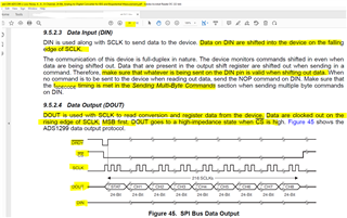

       If the known sinusoid signal is not presented correctly, then you may need to check the SPI communication -
       I suggest use single shot mode and probe the following pins and make sure each digital signal meet the timing diagram/requirement in the ADS1299 datasheet -
