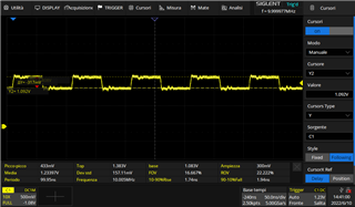

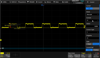

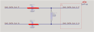

Here below the DATA clk ( LVDS ) and  the signals comes from directly FPGA and no external 100Ohm is mounted ( use internal DAC resistor )

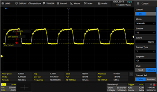

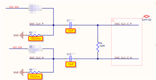

Here below the DAC clk ( LPECL20 )
