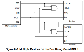

I need to design a AO module which need 2 ch output or 4 Ch output ver.
i see the ADI/AD5423, TI /DAC8760 meet my needs
AD5423 have the daisy chain, and DAC8760 remove the function
if i want to use four DAC8760 x4 in my board, how to control it?
please advise it,thanks
PS: I only need SPI, & one pin to control DAC8760
  • Alex,
    For the microcontroller, I would assume that there is a /CS, DIN, DOUT, and SCLK already to control a single SPI device. When controlling four devices, you can tie the DIN of all devices together and tie all the DOUT of all devices together. After that, LATCH pins would be controlled independently. The microcontroller would use other GPIO pins as the LATCH pin for the three other devices. However, the SCLK must be gated to the for each device.
    We show this in the datasheet on page 41 in this way:
    In the figure, SCLK is shut off for each device when the LATCH is high (similar to the /CS function in SPI). The figure shows connections for two devices, but this method of control expands to four with the addition of other GPIO pins that can act as extra /CS lines.

    I think the DAC8760 is the best device positioned to compete with the AD5423. While the gating of the SCLK requires an extra digital line, I would guess that the logic would be small.
    An alternate device would be the DAC8775, which has four configurable outputs. This device does have an integrated buck-boost converter, which may make the design a bit larger. I would note that each of the channels need to be individually and sequentially programmed and configured.

    For the DAC8775, this is just a single device with four output channels (various VOUT and IOUT ranges). In this device, there is a single SPI channel and there isn't a need for any of the SPI gating that is needed in the DAC8760. Again, I would have your customer review the datasheet to make sure that it suits their needs.
    The device does have an integrated buck-boost converter. It isn't absolutely needed for operation, if they have other supplies available. The DAC8775EVM is a good tool to review the device. They can use it to set up the configuration and review the features. The layout is not very compact, but they can look at it to see what needs to be included for the operation of the device.
