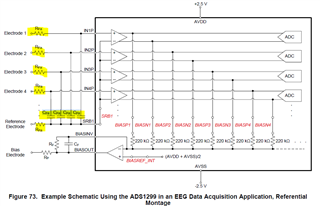

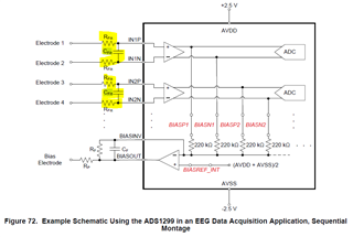

    The passive components RFilt and CFilt form low-pass filters. In general, the filter is advised to be formed by using
    a differential capacitor CFIlt that shunts the inputs rather than individual RC filters whose capacitors shunt to
    ground. The differential capacitor configuration significantly improves common-mode rejection because this
    approach removes dependence on component mismatch.

    The integrated bias amplifier serves two purposes in an EEG data acquisition system with the ADS1299. The
    bias amplifier provides a bias voltage that, when applied to the patient, keeps the measurement electrode
    common-mode voltage within the rails of the ADS1299. This scenario allows for dc coupling. In addition, the bias
    amplifier can be configured to provide negative common-mode feedback to the patient to cancel unwanted
    common-mode signals appearing on the electrodes. This feature is especially helpful because biopotential
    acquisition systems are notoriously prone to mains-frequency common-mode interference.

    Also please show me the schematic of the differential capacitor configuration.

    Also, does customer use the BIAS Amplifier and BIASOUT? It's one of the methods to suppress the common mode noises.
    The suggested schematic of the differential capacitor configuration is described in the datasheet Page 66~69 Section 10.2.2 Detailed Design Procedure mentioned above with screenshot.
    The ADS1299 EVM user guide page 51 also has/shows reference designs for the differential capacitors.
