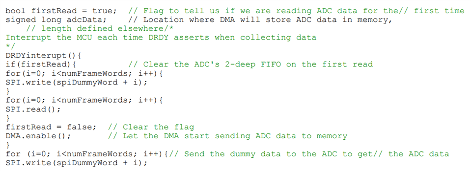

  • Hello Phil,
    Okay, thanks for the clarification.
    1)...[Do] I have to still read 10 words (24 bit words in my case) twice...?
    The short answer is yes, you'll need to read everything. The response and all channel data must be read twice. You can skip the CRC however. This is confirmed in the datasheet section 8.5.1.11 Short SPI Frames.
    "Quickly" is a bit relative but I think fair when comparing 16kSPS datarate vs. 25MHz SCLK, I think its fair. Not sure what SCLK you're running SPI at.
    2) So is it possible that I can pulse the SYNC pin low for my every sample to reliably clear the FIFO, then immediately read after, if so what is the pulse width I need do this (when considering my above conditions) ?
    Correct me if I'm wrong, but it looks like you continually plan on collecting data from the ADC. There will be very few pauses. The only unique process you want to implement is variably change the data rate while the ADC is running, which you can do with the external clock like we talked about.
    If everything I said above is true, then I think we need to talk about FIFO again. I tried to explain earlier that we really don't need to drop the SYNC pin low for the sake of clearing the FIFO if we are reading every single conversion. If you want to synchronize SYNC to something, then sure, you're using it correctly and we can talk about the width. Otherwise, strobing SYNC to clear the FIFO is only needed on the first read. Here's some code in the datasheet that helps illustrate that point:
    Just replace SPI.write(spiDummyWord + i); with StrobeSYNC(); //To Clear ADC's 2-deep FIFO. As you can see, the firstRead; is cleared and we won't need to clear the FIFO anymore. Hopefully that makes sense. And I apologize if this is something you already know, its just that your question states "pulse sync low every sample to clear FIFO" which does not need to be done if you actually want to read consecutive conversions with no pauses.
    As for timing of SYNC to trigger a resynchronization event to clear the FIFO, just need to keep SYNC low for >1 t_CLKIN keep it high just as long, and then drop it low again so that this whole process is less than the data rate. Nothing too special there.
    -Cole

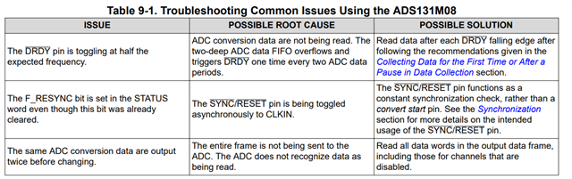

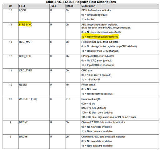

  • Hi Phil,
    Yes, seeing half the expected data rate is a common issue related to everything we've been talking about.
    I know you haven't shown a zoomed in version of the the SYNC signal but what I imagine happened is that the SYNC pulse didn't trigger a resynchronization action and the FIFO continued to be full. This is under the assumption that you are reading every nDRDY toggle like you say. It could be fair that the whole SPI frame isn't being completed as expected and that causes one of the channel's FIFO to remain full. In the context of having multiple ADCs, using the SYNC is definitely the way to go.
    Either way, I think once you figure out how to properly clear the FIFOs on all of your ADCs, all of these issues will go away. One debug step I encourage you is to send a NULL command or read the STATUS register and ensure F_RESYNC is 1b after reading the next data that pops out after SYNC toggles.
    -Cole

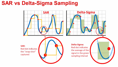

    Intro
    Inherently, delta-sigma ADCs average which makes precise timing measurements that start and stop inherently challenging. SARs have much less difficulty doing this. A typical question from those learning about delta-sigmas is: when does the conversion start and end? The short answer to that is, as soon as nDRDY toggles low.

    Maybe we need another device:
    Delta-sigmas average, and SARs don't. Are we sure a delta-sigma is what you need or can a SAR get you the performance you want?
    Perhaps if you have more information on your project's specifications or what your end application is, we can help there. For example, the ADS131M0x was specifically designed for electronic metering, circuit breakers, metrology, and battery test equipment.
