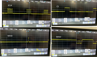

    This is what I measured SCLK and MOSI with oscilloscope.

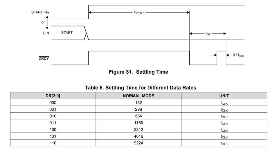

    Your formatting for the START and STOP commands look correct but you didn't wait long enough for nDRDY to attempt and toggle. In your previous picture, you showed
    When I just pull START low, I can see that DRDY has waveform, but after I pull it high, the waveform disappear

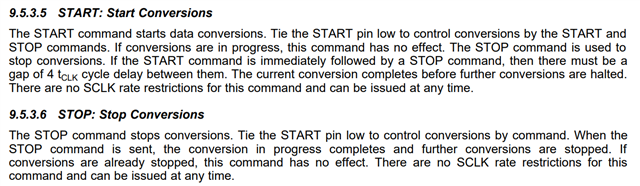

    It takes almost ~143us before nDRDY toggles. This is explained in the datasheet:
    Sending a START command is effectively the same action as using the START pin. You need to wait for the settling time to see if nDRDY actually toggles before sending a STOP command. I'd recommend adding some margin (t_settle + t_DR after completing the START command via SPI).
    Going back to this, I realized you don't have MISO and CS on the oscilloscope screenshot. Do you have the ability to probe all 4 channels at the same time or can you only do 2? If you can only do two, I'd ask to capture the same command with MICO and CS, with the same voltage and time division, so I can put them all on one screen and do an analysis of the timing.
    -Cole
  • Hello Cole
    I can capture 4 channels, but MOSI has no output, so I only measured the data of SCLK, CS and MOSI.
    But nothing seems to be wrong.

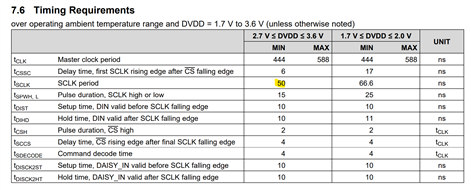

    SCLK of 8MHz is within the valid range, the fastest it can be 20MHz (1/50ns of SCLK period spec). Aa you notice, there's no minimum spec. You can actually run SCLK as slow as you want and it will work (assuming you don't have a SPI timeout).

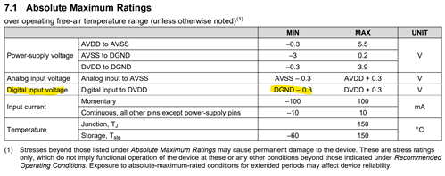

    Unfortunately, the SCLK looks even worse than the previous oscilloscope screenshot. Now it has 1V overshoot. Also note, I'm getting concerned with the undershoot on SCLK as well.
    SCLK is considered a digital input and you are going 0.5V below DGND. With repeated exposure, this could result in damage to the device. You'll need to connect more GND wires, make the wires thicker, make them shorter, or some other combination before we proceed.
    -Cole

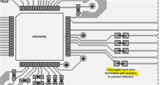

    This is the result after I connected the four SPI signal cables with 130 ohms resistance in series, and it looks like I successfully returned the ID number.
    However, I have a question, are the maximum and minimum values of CS signal here normal? It's only tens of millivolts.
  • Hi Zhen,
    That looks like an improvement nice job. Looks like series resistors were recommended by the datasheet too:

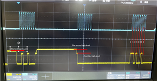

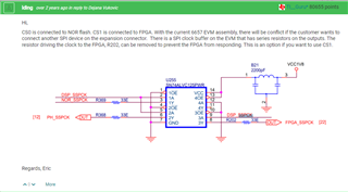

    Bus Contention:
    From your screenshot, you can clearly see there are two separate logic levels that are fighting for control. You have mentioned DVDD = 1.8V, which is the intended value of high's and low's for the SPI line. However, I see ~1.8V-2.0V and ~3.3V. This is called Bus Contention, I encourage you to search externally to learn some more.
    Anyways, this sometimes happens if you're supplying 1.8V to DVDD on the ADC but the MCU is trying to output another. You will need to look into the MCU's settings and see what the logic value high output voltage is for the MCU pin you are using. Something tells me, once you fix that, your SPI interface will be done.

    3、In addition, it can be seen from the figure that the output of MOSI should be ~1V and ~1.8V. This is the signal output of ADS131E08, it should be the problem of ADS.
    Not sure what figure you are talking about. None of the waveforms for MOSI have been ~1V. The waveforms look like ~1.8V or ~2V max which shows the device is working as expected.
    Below shows that the minimum should be 0.9*DVDD. We've assumed that DVDD = 1.8V so 0.9*1.8 = 1.62V. If the output was 1V, this would indicate that DVDD is low or that the device might be broken in some way as it would outside of the specification.
    But you are correct, if there was a problem of the output of the ADS digital output (MOSI) then it was be the fault of the ADS. Maybe we can probe DVDD directly and see if it is stable and around 1.8V?

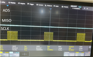

    The problem with the previous CS measurement value is that the oscilloscope probe is faulty.
    Now, I use the same probe to measure SCLK, CS, MOSI, and MISO. As can be seen from the picture, except MISO, the other three signals should be normal. I wonder if the previous input voltage exceeds the limit value of ADS131E08, leading to its damage, and thus causing the abnormal output of MISO?

    I just want to confirm that you are measuring the MISO line at or near the DOUT pin of the ADC, and the ground lead connected near GND pins of the ADC. I wouldn't necessarily say J1 is particularly close. Because of inductance in the GND plane, we might not be able to assume the voltage seen at J1 is the same seen at the pins of the device.
    So, to confirm our assumptions, I suggest measuring the same signal close the the pins of the device. After that, I suggest you measure the same signal close to the MCU and see if there's a difference.  Again, this is what some would call a "sanity check" and it is usually a test that seems mundane but its purpose is to make sure we are not working on invalid assumptions.

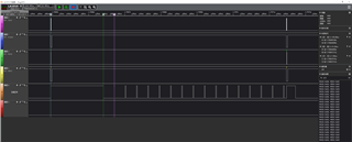

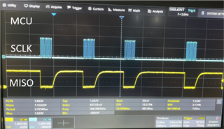

    If I use the logic analyzer to measure the DOUT of the ADS131E08, I can read all the register values, and I can change the register values. It may be that the logic analyzer has a high level threshold of 0.9V, so it is able to identify the previously problematic waveform.
    However, for the MCU, the ID "0xD2" returns to the MCU as "0x36". So, due to the MISO output problem, the ID is still not actually obtained correctly.
    I'm a little confused by this. So, only when the logic analyzer is plugged in the MCU can correctly read and write to registers. This would include the device ID. But if you remove it then the MCU get the incorrect one?
    Or the logic analyzer give the correct value no matter what and the MCU always gets the incorrect value?
    When took one of your old screenshots, I counted where the register data should be and it seems to match with 0xD4 (0b11010010) (I drew the lines as best I could). 0x36 seems to line up with the first waveform when you're actually issuing the RREG command and DOUT is technically a "don't care" waveform. Try adjusting the code so it waits for the 3rd set of SCLKs to read the data there.

    What I mean is that I use a logic analyzer instead of an oscilloscope to measure the SPI signal at J1, and then decode the signal. I find that I can identify the ID number, and when I modify CONFIG1, I can then read out the modified register value. It is possible that the logic analyzer's high level threshold is 0.9V, so the previous magnitude of ~1V is recognizable to the logic analyzer.
    4.I think 0b11010010 is 0xD2. Also, 0x36 is the DATA returned at the last 0x00 in "0x20 0x00 0x00", so it is the DATA at "REG DATA".

    Which source determined the 0x36? The MCU, the logic analyzer, or the oscilloscope?
    At this point, the only signal I know I can trust is the oscilloscope. I'm not sure if you resolved the threshold issue on the logic analyzer or what it says now. In addition, the MCU hasn't really given a correct value that we can trust (unless you have proof of that by reading the default of some of the other registers and comparing them to the oscilloscope screenshot).
    The oscilloscope screenshot you posted very clearly does not match 0b0011 0110 (0x36 if I copied and pasted correctly this time) on the oscilloscope. There is only one section with a 0b11, the other section looks like 0b01001. Depending if the MCU or Logical analyzer is giving you 0x36, you'll have different steps in debug. My guess is that 0x36 is from the MCU which means you'll need to do some debug on your code until is can accurately give us what the oscilloscope shows.

    But MISO output three types of high levels, DVDD is stable at about 1.8V, high level should be the second case. Why do the other two wrong high level voltages occur?
    I agree, this will probably solve the last problem. Let me consult with the team for a couple of days and see if I can come up with something to try.

  • Hi Zhen,
    Can we do a test by disconnecting the MISO wire from the MCU and checking it on the EVM only? The MCU can still ask to see the data through SPI but not connect the line to the MCU and probe it with an oscilloscope to verify the behavior.
    If we measure the EVM and don't see the behavior anymore, then we can agree the MCU is causing the issue. The team seems to agree that it is bus contention. Sometimes, there's weak pull-downs that can be enabled or disabled on the MCU GPIO side and its clear the MCU can pull down to GND very easily but can't quite reach the 1.8V logic level which would indicate its pulled down. Some users have to change libraries or modify them to get rid of waveforms like this.
    If we see the same behavior on the EVM, we'll debug from there but there isn't a good explanation from the team that the ADS could be causing the issue.
    -Cole
  • Hi Cole,
    Thank you very much for the testing protocol.
    1.According to your suggestion, I have tested the MISO of both. When I test the MISO of MCU, I can see that there is a waveform display, but when I test the DOUT of ADS, there is no waveform. So, this should be what you call bus competition. But how do I solve it?
    2.As far as I know, 6678EVM is the same as 6657EVM in SPI design. So I removed R202 in accordance with the Iding's advice. So now CS1 is only connected to ADS. Will such a master and slave have the problem of bus competition?
    -Zhen
  • Hi Zhen,
    Interesting result!
    I think this is a little out of the realm of my expertise. I know that setting up GPIOs and SPI pins will be associated with settings that can be adjusted in software. E.g. you can manually change the same SPI SCLK pin from 1.8V to 3.3V or 2.4V by changing some settings. Sometimes, these are buried within libraries or initialization routines where the pin is defined with both 1.8V and 3.3V depending on what's happening. Sometimes, like shown in your follow up, there's some translator or buffer in HW on the board that helps bump up the voltage to a certain level, so following the trace from connector to pin could give you some clues since SPI is usually shared. All of this could contribute to bus contention.
    Unfortunately, I don't know anything about the 6657EVM or the buffer circuit you showed. I think the best way to do this is to ask a related question based on this thread with the orange button above and let them know there's a SPI contention issue. Show the MISO before and after screenshots and ask if anything in HW or SW that could be causing this, because the debug has clearly shown that the ADS131M0x is not at fault.
    Wish I could help more, I'll try to find the new thread you post and follow it so I can help explain anything that's needed by the 6657 team.
    -Cole

  • Hi Cole
    In addition, I have a question.
    When SCLK, CS and MOSI are used to connect MCU and ADS, and the DOUT of ADS is measured after disconnecting MISO, why is its output kept low from the oscilloscope waveform?
    Since the MISO of the two is not connected, the MCU should have no effect on the ADS on the MISO pin? For ADS, when the correct command is received, its DOUT should have an output.
  • No problem Zhen.
    Hmm, I think I missed this in the previous post, sorry about that.
    The DOUT/MISO should be correct for whatever command you put in. So, if we're still trying to read the ID then you should get 0xD2 on the ADS side. What command is sent for this waveform? Can you provide MISO, MOSI, and SCLK on the same screenshot again? Definitely double check the probe on a known voltage as a sanity check.
    The MCU side still pulling to GND when SCLK is toggling is still a problem that needs to be solved. Keep me updated with what might be happening there.
    However, I wonder if there is some sort of loop that's happening when DOUT is connected to the MCU, but its a bit to early to speculate. I'll wait for the data.
    -Cole

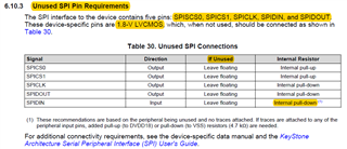

  • Hi Cole
    When I looked through the manuals for the 6678DSP, I found the problem. SPIDIN is dropdown by default when CS1 is used. Even though I removed the R202 earlier, selecting CS1 will still make it drop down.
    And then I see that CS0 is connected to Flash, and I can see that the MISO at Flash is pulled up, right? So I plan to remove this Flash and communicate with ADS through the SPI interface of Flash. I think that should be all right.
    -Zhen
  • Hi Zhen,
    Good find, this was exactly the kind of thing we should look for. In general, I don't know if that flash is necessary in anyway but I don't see an issue with removing and trying again. Let me know how it goes. Also, you can always ask the 6678EVM folks if they think there's any issues but I don't see any.
    -Cole
