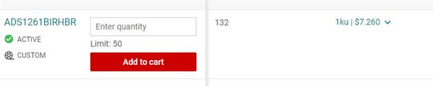

    Also, I am showing a small quantity of this device currently available in the TI store, if you are interested.
