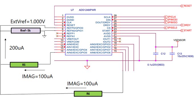

I have created a configuration to measure the differential voltages of AIN5 and AIN6.

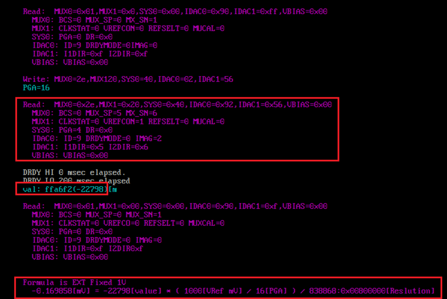

In the external reference measurement, which has already been verified to be correct, the ADC readout for the differential measurement of AIN5 and AIN6 is 0xffa724 (-22748).
The following voltage conversion equation is used
Vout _ext= -22748[value] * ( ( ( 100[IMAG uA] * 2 * 0.001) * 5000[VRef mV] / 16[PGA] ) / 8388608:0x00800000[Resolution] =-0.169485[mV]
or Vout_ext = -22748[value] * ( 1000[VRef mV] / 16[PGA] ) / 8388608:0x00800000[Resolution] = -0.169485[mV]

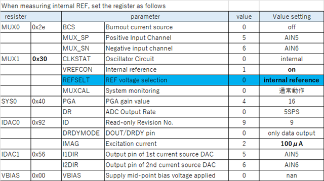

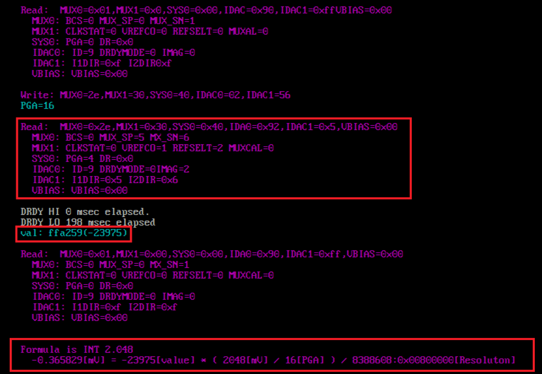

On the other hand, the ADC readout value for the differential measurement of AIN5 and AIN6 using the internal reference was 0xffa259 (-23975). This is almost the same as the ADC readout of the external reference value.
The following voltage conversion equation was used
Vout_int=-0.365829[mV] = -23975[value] * ( 2048[VRef mV] / 16[PGA] ) / 8388608:0x00800000[Resolution])
I think this is a strange result, since the weights per LSB are 2.048 times different, so the ADC readout should be 2.048 times different.

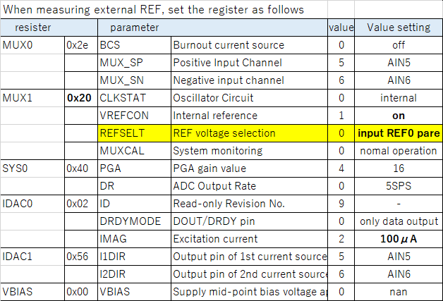

Here are the settings when measuring using the external REF

The settings for measurement using the internal REF are as follows
The system configuration of  ADS1248 and measuring resistors is shown in the figure below.

    It is reasonable to give a small value since you measured the differential voltage across lead resistors with the same value, AIN5 and AIN6.
    The resistor values used for the measurements are R5=1kΩ±1% and R6=1kΩ±1% respectively.
    As shown in the following calculation, the differential resistance value is a few ohms, so the smaller value is output and is the correct result.
    Expected measurement voltage = (R5-R6)*100uA ~1.7Ω*100uA ~170uV

    >have you confirmed that you are writing to the registers correctly? Please perform a register read back whenever you change the ADC register settings to ensure that the new register settings are being Please perform >a register read back whenever you change the ADC register settings to ensure that the new register settings are being properly loaded into the ADC.
    We have already confirmed that both the external and internal REFs are set correctly by reading back the registers after writing to them.
    Please check the following image.
    Translated with www.DeepL.com/Translator (free version)
    Fig1: Results of resister write & read (external reference)

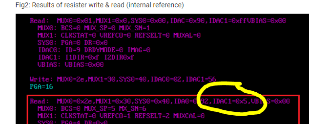

    Fig2: Results of resister write & read (internal reference)

    The register read back appears to be working correctly in most cases.
    I am not sure if this is an issue, but the text on the screen for the internal reference read back shows that IDAC1 = 0x5, while it should be IDAC1 = 0x56.
    Is this readback valid? It might be useful to double check the ADC output with a logic analyzer during the read back, just to confirm that the values are correct.

  • >I am not sure if this is an issue, but the text on the screen for the internal reference read back shows that IDAC1 = 0x5, while it should be IDAC1 = 0x56.
    I will check and answer later.
    It just so happens that the data reading data is missing. After repeated checks, the correct values were displayed.
