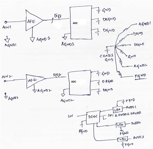

Hi
I have a design as below, where the data conversion is happening at a sampling rate of 500MSPS and signal is of range 200MHZ
There are two adcs in my design,
1. is it correct way to create seperate AGND ground place for two ADCs ?
2. is it ok to common the Digital ground plance for both ADCs ?
3. coming to PGND the dcdc and LDOs will have same PGND which is taken to AGND via bead
4. is it appropriate to common the grounds in a star connection ?
Let me know if any extra care need to be taken.
5. The layout may tentatively look like below.
