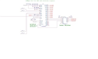

I am using ADC3663IRSBT to simultaneously acquire two channels at 50MHz. From DFT result, I noticed that 20% of time, the phase difference changes about 5 degrees for a sinusoidal wave of 2MHz. To figure out the problem, I set the ADC into ramping up mode with step of 1 so that I can know the exact number I would get. After many tests, I found the reason is related to the unstable behavior of ADC after power down and then power up. The following is my test results:
“ADC power down”: using PDN/SNC pin or SPI command to power down ADC so that it won’t consume power
“ADC power up”: using PDN/SNC pin or SPI command to power up ADC for acquisition
“ADC Reset”: using SPI command to reset ADC to default register states and then initialize registers as 16-bit 2 wire ramping up mode with step of 1
Test 1: power up the board, then “ADC power up” , then “ADC Reset”, never “ADC power down” or “ADC Reset” again; in this case, there is no error and ramping ADC number received correct after hundreds starting acquisition; each acquisition will start and then stop FPGA synchronization/acquire interface; this proves that issues are not from FPGA
Test 2: power up the board, then “ADC power up” , then “ADC Reset”, then for each acquisition, "ADC power up" and “ADC RESET” at the beginning of each acquisition, and “ADC power down” at the end of each acquisition; among hundreds of acquisitions, the error is about 40% (when error happens, all data are not correct in that acquisition); if I only do "ADC power up " and “ADC RESET” , not do “ADC power down”, the error rate is about 1%, but error still exists; if I only do “ADC power up” and “ADC power up”, once error starts, it will never recover from error  even after many “power down” and “power up”.
From above test, it seems that after power down, the ADC can not work properly after power up and even with "ADC Reset", or maybe something related how I do “ADC Reset”? the following is my reset code. Another possibility is that I did not have any connection to RESET pin of ADC since it has internal pull down resistor, can that be a issue? or do I have to toggle the hardware "RESET" pin so that the ADC can work properly?

         As I noted previously, there is no connection to the "RESET" pin of ADC, so I currently only use "software reset" by sending a SPI reset command.

    The hardware reset is not required - only performing the software reset is not a problem. At any point, is the clock signal removed/disabled from the ADC prior to reset? I am wondering if the clock is not present during the software reset for some instances. The clock presence is mandatory before toggling reset via either a hardware or software reset. This is crucial for the device to reset all internal functions.
    Regards, Chase
  • Hi, Chase:
          After I found that AD values were not correct, I have been using ramping up mode with step of 1 to test. When error happens, the received AD value is not in the sequence of step of 1 and the values are jumping around. When it works, the AD values is ramping up with step of 1 constantly.
         The master clock to ADC is always present after power up since the oscillator is connected to +3.3V supply.
          Do you have an evaluation board to also do the software reset and ramping up test to see whether you have the same symptom?
  • The +3.3V oscillator clock is passed to FPGA and FPGA output the same 50MHz clock with I/O of 1.8V which is the same as AD. Once power up, it keeps running forever.
